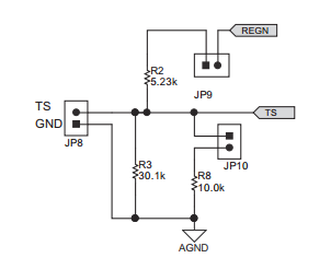

3. On my board, I measure the TS is 3V, does this means I do not need to connect the thermistor between TS->GND pin? can I ignored the thermistor to save cost?

    • The thermistor can be omitted from the design to save cost, but a resistor network to fix the TS pin voltage should be used. Typically we recommend customers to use the following resistor network to fix the TS pin at a voltage corresponding at a normal charging temperature.

    Could you monitor the TS pin to verify the voltage is not fluctuating in and out of Hot/Cold window, disabling and enabling charging?
