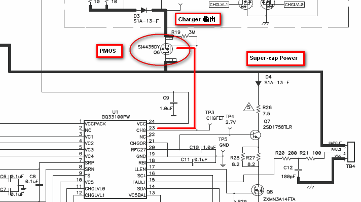

I have meet an issue about during charging, when during charging and super-cap voltage about ~ 0V , CHGFET we always measurement this point about 2.5V,  cause  P-MOSFET not fully turn on and overheat.
it possible to let this pin close to 0V when charging?
