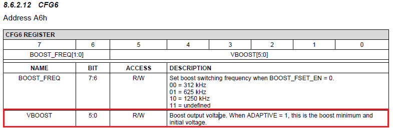

My customer considers to use "Adaptive Boost Voltage Control".
How to calculate specific boost output voltage [V] from VBOOST[5:0] of CFG6 register?
Yaita / Japan disty
It's on page 14 of LP8556 datasheet.
Vboost = Vboost_min + 0.42*VBOOST(Dec), where Vboost_min can be decided by VBOOST_RANGE either 7V or 16V.
Hope this helps,
Hi Yoon-san,
I totally thought the following calculating formula is for "Manual Control" only.
*Vboost = Vboost_min + 0.42*VBOOST(Dec),
I understood it is applicable for "Adaptive Control".
Thank you for your support.
