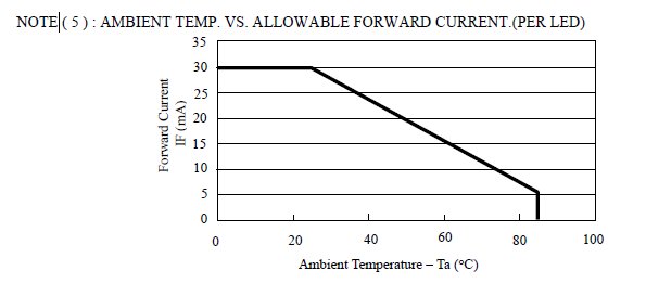

Technical data display:
Power Supply for LED Backlight:  IF=40mA VF MIN=28V TYP=30V MAX=32V

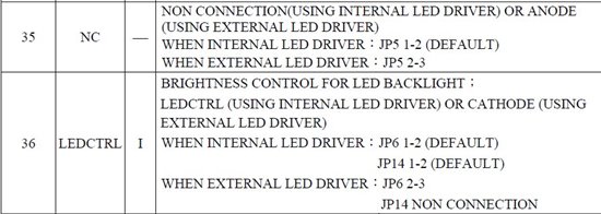

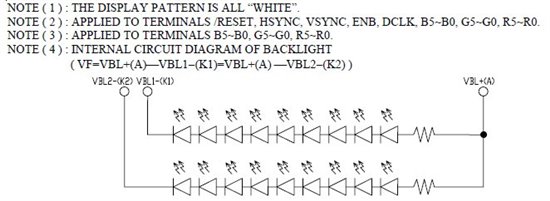

    ive attached the necessary information.
    it is a dual string but at the connector (pin 35 and pin36)  is only two pole (anode and cathode)

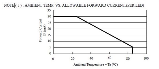

    i mean with temperature compensation:
    i thought temperature compensation is required (for all backlights):
          if ambient temperature increase, the led current need to decrease. See diagram @ the first post, or im wrong?
  • So pin 36 ties VLB2-K2 and VBL1-K1 together? That is okay and the TPS61161 should be able to power this string of LEDs, assuming the input voltage to the TPS61161 is high enough.  If the input voltage is not high enough, then you could move to the TPS61165 IC.  Regardless, the currents through each string will not be split evenly.   That may be okay if the LEDs are inter-mingled behind the display.  Regarding temperature compensation, our IC, by itself will not provide temperature compensation.   You would need to provide a signal to the TPS61161's CTRL pin to dim the part as needed.
