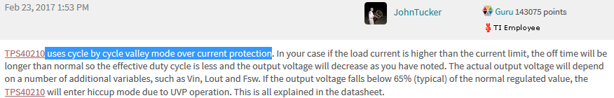

May I know how to explain TPS40210 uses cycle by cycle valley mode when over current ?
As I know cycle by cycle should be compare ISES pin and COM pin to tune PWM duty, right? But I can't find OC behavior description in TPS40210 DS. Thanks.
