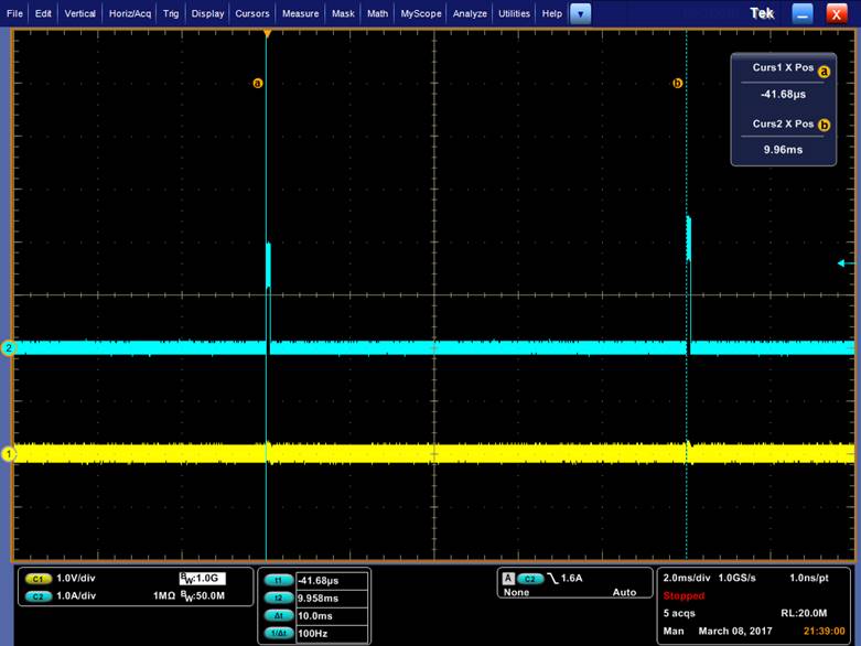

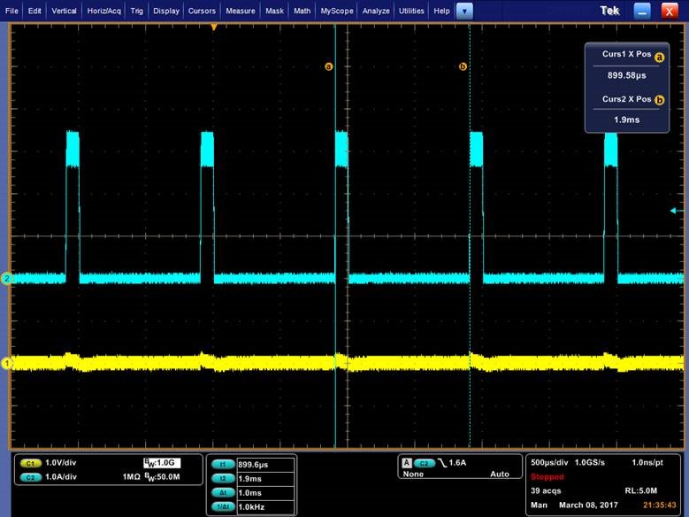

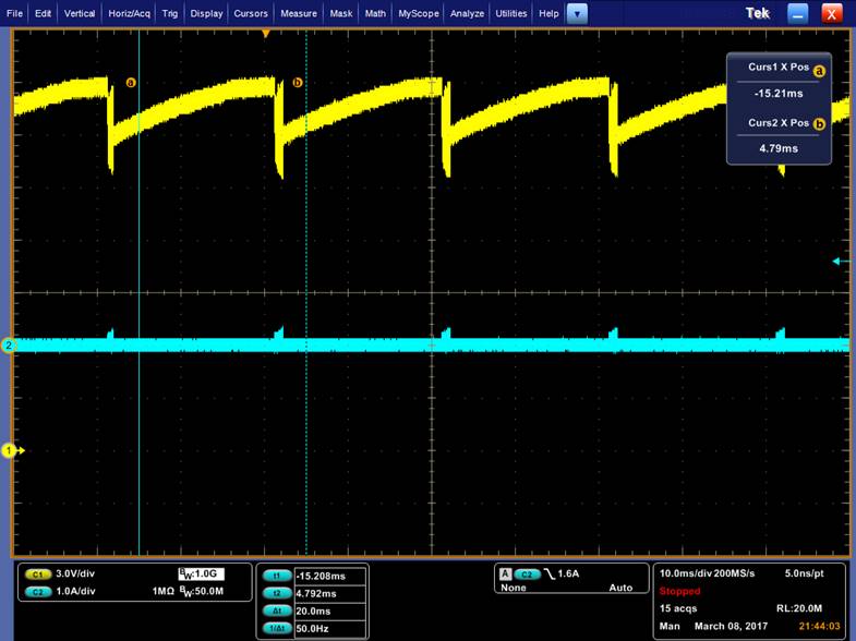

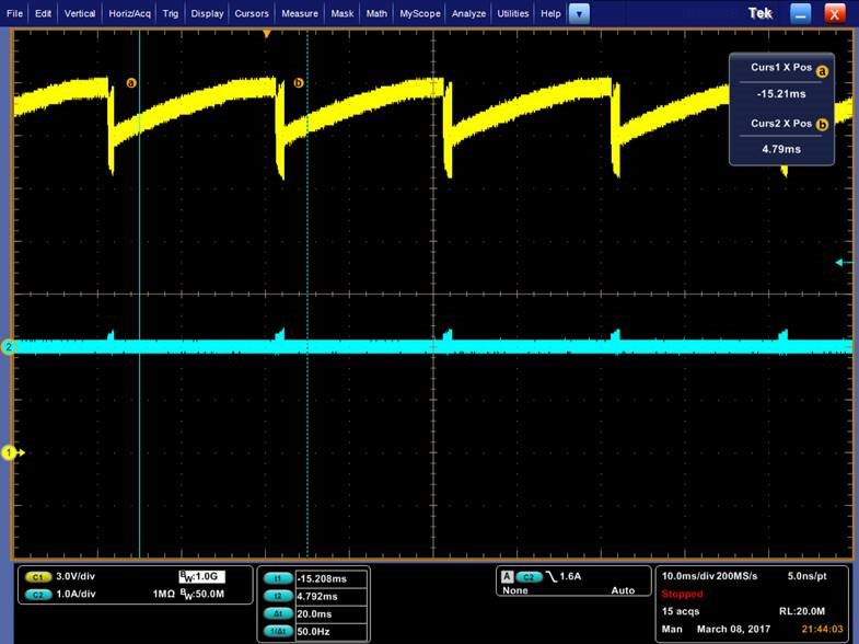

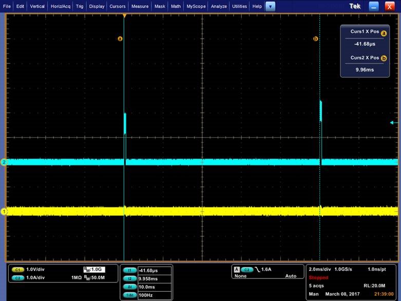

    From your comments, it seems to be going into a shutdown mode.  I have attached some waveform showing my issue.
    Pulse frequency at 1kHz is fine.
    Pulse Frequency at 100Hz, the current is not the same from pulse to pulse.  For this application, we need to skip one or two pulses once in a while.  It may explain this behavior.
    Pulse frequency at 50Hz, no pulse is present.  I also added the VCC voltage in channel 1.  I think it is waking up but the pulse width is not long enough to reach the full current.

  • Hello Chuchen,
    You are correct, when the frequency is low enough it goes into shutdown with the EN pin. Using UVLO will work better in this case. They act exactly the same except that when EN is pulled low VCC is allowed to discharge until you hit shutdown mode. UVLO low will keep VCC high so the response will be fast whereas you need to wait for VCC to charge if using EN. You can apply a signal directly to UVLO or you can still use resistors for a UVLO function and OR in a signal with a diode. You can look at the LM3429 datasheet for an example. In any case use UVLO rather than EN for your PWM dimming and it will work great at the lower frequencies you are using.
