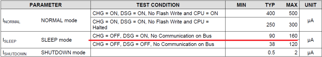

3、Battery pack factory configured to SLEEP mode, the leakage current is 90 ~ 160 uA, are there any ways to reduce the leakage current?
    OA: This is not leakage current but rather the gauge current consumption. You can configure the charge and dishcarge  fets to be turned off in sleep mode essentially disabling the charge pumps and reducing the current consumption to 38uA.
