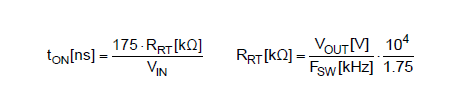

We are checking how to calculate Ton time of COT control.
There is no description on the LM 5165 data sheet, but it is on the LM 5166 data sheet.
There are 175 parameters in the LM 5166 with the following attached formula, but we believe that the LM 5165 will be 160. Is my opinion correct?
Also, is the calculation formula of Ton time of CCM, DCM and DEM the same?
