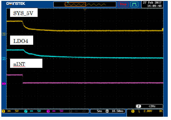

The nINT pin is asserted when PWR_EN goes low as follows.
Is it correct working?

  • Kuramochi,
    The pull up voltage of nINT should be always ON. As the PWR_EN low will disable LDO4, nINT will be driven low. On EVM, we have nINT pulled up to 3p3 rail from USB2ANY which is always ON.
    Jay

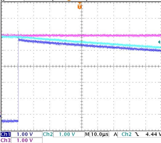

  • Hi Rick,
    You can see a screenshot of the Bat pin on this thread.
    e2e.ti.com/.../582785
    Jay suggests that since the pulse seen on Bat during the transition form Sys to Bat is only around 1ms this would not affect AC detection.
    We have more details about the unintentional reboot on this thread.
    e2e.ti.com/.../570339
    AC stays ON the whole time, but we've seen some noise on the line causing max short 400mv dips. We've suppressed these to less than 100 mV with some large bypass caps but still get the same errors.

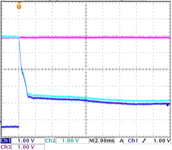

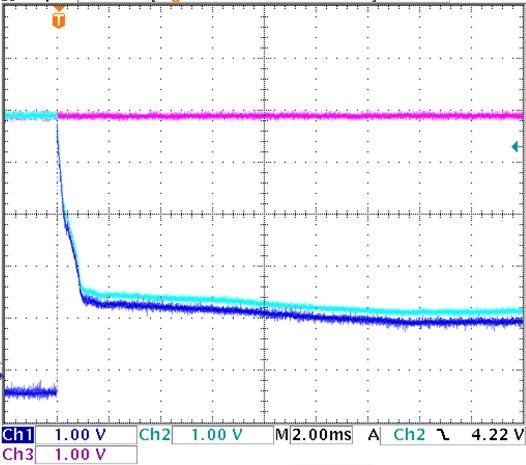

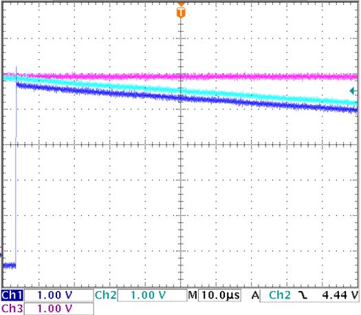

  • Hi Rick,
    The following screenshots show a shutdown by disabling the AC power path in the PMIC registers.  I had to use our test board, which has a problem with its RTC, for capturing the waveforms. Our "good" boards aren't allowed to be probed at the moment, so I was limited to disabling the AC power path.
    Anyways, the AC power path disable method was showing the same interrupt and reboot behavior as the PWR_EN shutdown method. We've tested the current limit fix on our "good" boards, too, showing no interrupts nor reboot.
    (Pink=VAC; LightBlue=SYS; DarkBlue=BAT)
    AC current limit at 2500mA (reboot occurs after 1 second):
    AC current limit at 500mA (does not reboot):
      (*this last scopeshot was updated, wrong shot was initially posted, now it's ok)

  • Hi Rick,
    We scoped a little deeper and measured the Rising Edge of the BAT pin in the reboot case rising about 4 usec earlier than when we set the AC current limit to 500mA.
    Could it be that by decreasing IAC limit to 500mA, we are forcing IBAT to go below the termination current threshold therefore turning off the charger and somehow delaying the connection between SYS and BAT pins?
    Interesting thing too, we tried disabling the PMIC charger by I2C register settings. If we disable the charger before sending a shutdown -h now command we will get the interrupt event and the system will reboot after one second of SYS dropping.  But, if we disable the charger by writing to the register just before setting ALARM2 to signal a shutdown then we don't get an interrupt and the system shuts down cleanly.
    I think this is hinting that the BAT charger is in someway interfering with AC detection.
    Any thoughts on this?

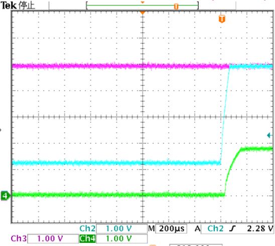

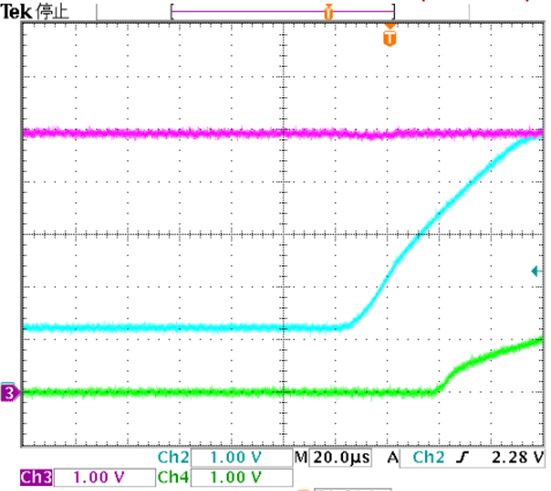

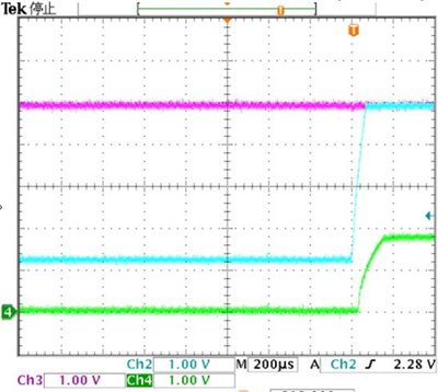

  • Hi Rick,
    We were measuring from a wire soldered to the test point on the other side of the board around 5mm away from the IC pin, so pretty far.  But, we tried again this time at the bypass cap about 1mm from the IC pin.
    Here's a scope shot of the restarting part:
    Pink-AC; LightBlue-SYS; Green-LDO1

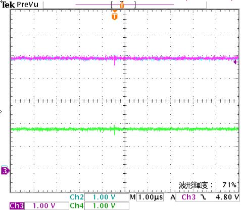

    I also tried catching any dips on the AC line by setting a 4.8V falling edge trigger on the AC signal. We would see small drops of about 200mV for about 25nsec. We've actually been seeing this all over the AC line before but figured that it's too small to cause an AC detect. We also see this noise on our other Beaglebone based projects that don't reboot on shutdown.
    How small can a dip on AC be to trigger an AC detect event?
    Removal detection voltage threshold for a no battery application like ours would be 3.5V and below - far from anything we're seeing on AC. But if the spike on BAT pin is indeed interfering with AC detection, then removal detection voltage threshold would be VAC - VBAT < 125mV. I understand the detection deglitch is 22.5ms, but if I understood the datasheet correctly this isn't applied to removal detection (I'm not so sure)? So let's say VBAT was greater than VUVLO(3.5V) for around 200uS during the BAT pin spike on shutdown.  VBAT just has to be greater than 4.875V to satisfy a removal detection, which it seems like it's doing for about 10usec more or less.
    The confusing part is, we've recreated the BAT pin behavior on one of our other boards, but didn't get a reboot on shutdown.
    Thanks again for the assistance.

  • Just following up. How small of a dip could cause an AC detect event? And what's the minimum duration?
  • Hi Jesse,
    Experimenting on an EVM, if I disable the AC power-path and then use the push-button to restart the PMIC, the PMIC will register an AC detect interrupt rather than a push-button interrupt. This may be due to the way the part handles a fault event, where the following wakeup event actually resets the device.
    Without a battery a dip would have to go below UVLO+offset, where UVLO has a 4 to 6ms deglitch time and is configured by the UVLO register.
