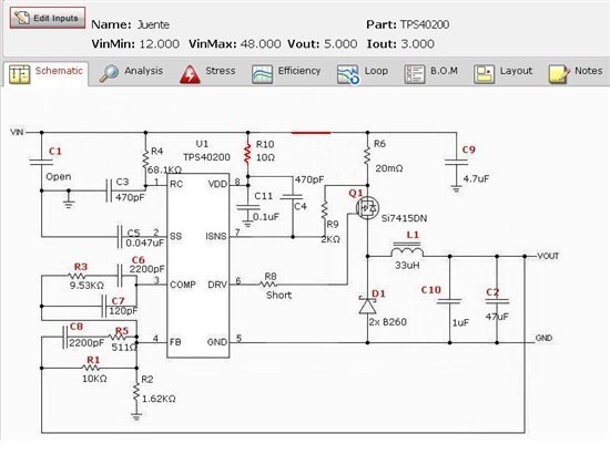

I've designed a switching power supply using the TPS40200 controller. I made it using the SwitcherPro tool offered in TI Website.
If you try a design with the followings parameters,
TPS40200
V input min: 12V
V input max: 48V
V output: 5V
I output max: 3A
you will see a resistor (R10) of 10ohms between Vcc INPUT and the (C9) 4.7uF pump capacitor. Such resistor is a 0805 standard which does not disipate more than 0.10W. I think there is a mistake in the VccINPUT point of entrance. Shouldn't it enter from the 4.7uF end? That way, R10 will serve as Low Pass filter altogether with (C11) at the TPS40200 Vdd input (pin 8).
If I connect Vcc INPUT in the point specified in the SwitcherPro schematic, (R10) will not supply enough current to the 4.7uF and MOSFET.
Another question is: There is NO consistency between Schematic and Layout presented in the same SwitcherPro tool. You will find there is no resistor between Vcc INPUT and Rsense. Moreover, Rsense is (R6) in the schematic but this appears in the place of (R2), the FeedBack for the TPS40200.
I think there are some mistakes with SwitcherPro, let me know if I am wrong. And let me know too whether proceed with ensambling or not.

  • Yes, R10 should be in a vertical orientation between VIN and VDD, forming a low-pass filter with C11.
    When R10 is used, the time constant R10 * C11 should be equal to the time constant R9 * C4
    I will look into the layout / schematic reference designator issues.

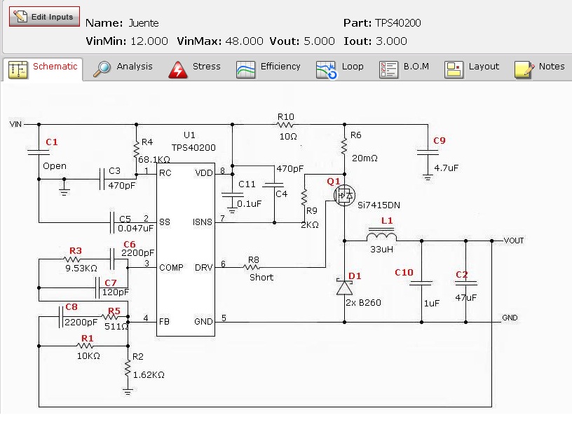

    I've checked the on-line version of SwitcherPro today:
    The switcher pro team decided to move VIN and C1 from the right side of the circuit to the left side of the circuit to correct the configuration.
    If you have the desktop version of Switcher Pro, you will need to update your version for this change to take effect.
    The critical factor is:
    R10 should be between the power stage input voltage (VIN) and the VDD pin of the TPS40200 controller (Pin 8).
    In the original schematic VDD was directly connected to VIN and R10 was located between VIN and R6, which required all of the power stage current to flow through R10.

    For clarity here is the original Switcher Pro schematic with the change I was trying to describe in RED
    R10 has been moved into the vertical trace between the VIN node (the node across the top of the schematic with connections to C1, R4, R10, R6 and C9) and the VDD node with connections to U1 Pin 8, C11 and C4.
    The above schematic and the new switcher pro schematic (from my last post) are slightly different electrically.  In the above schematic R4 is connected from VIN to RC (U1 Pin 1) while in the new switcher pro schematic R4 is from the VDD node (U1 Pin 8) to the RC node (U1 Pin 1).  The new switcher pro schematic is actually the prefered configuration as this draws the oscillator current (current through R4 into RC) and the oscillator peak-voltage reference (VDD / 10) from the same voltage and improves the voltage feed forward functionality during a line transient.
