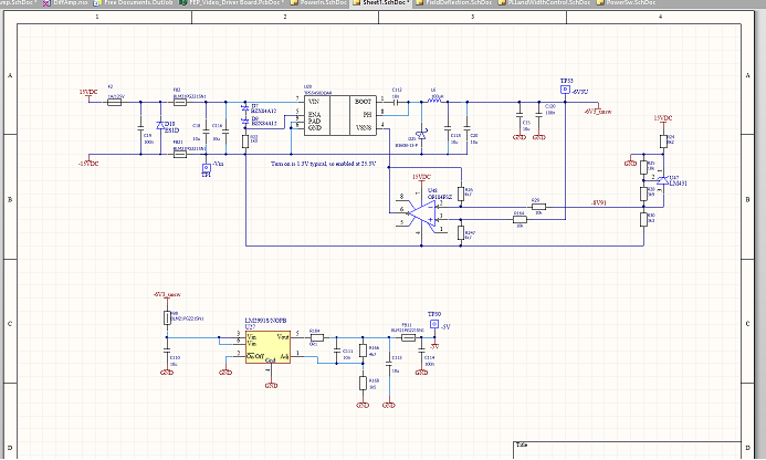

I'm generating +6.3 V and -6.3V using +/-15Vs
My +6.3V rail is working fine with TPS5450
But My -6.3V rail is not performing correctly. When I added a load the -6.3V drops to -1.9V.
Can't I use TPS5450 for negative voltages?
