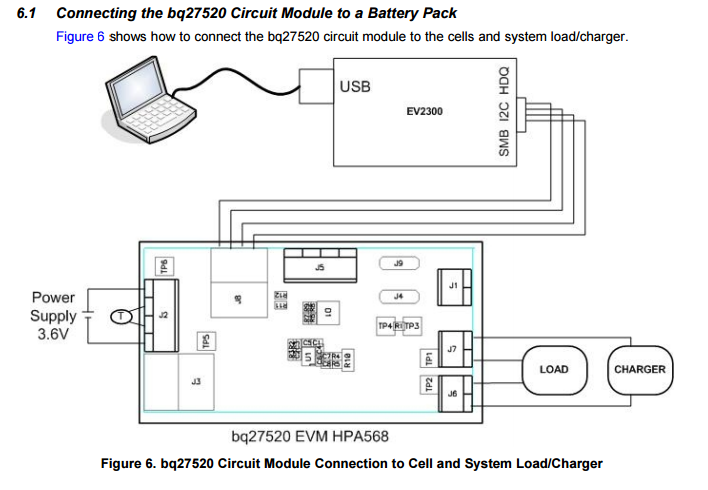

  • Hi, Onyx
    Thank you very much for the reply.
    How can the cell be fully relaxed? What ever I discharge to empty and leave it there for more than one day,  or charge to full and leave it there for more than one day, I never saw the VOK bit been set.
    According to the document, first I need see VOK been set, then after full discharge/charge and relax, I need see VOK been clear.
    From sluu426b, Figure 6, for my understanding, the "Power Supply 3.6V" is our battery, right? Do we need another power supply for the evm board? Because we just use the battery to supply power. Is this cause the battery not relax? If we need another power supply, Which pin should connect on the evm board?
