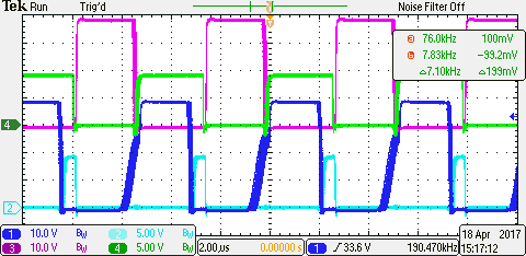

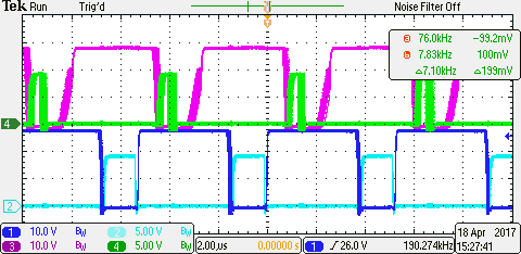

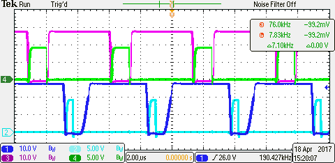

    I found that the power limit is hit at 50C causing the previous issue. I changed the sense resistor to 2x 0.5mohm and the power limit is avoided. However, I observed in other unit that low_drive in one of the phases is terminated earlier causing lower efficiency at some conditions.
    Are you saying that you have programmed Forced CCM mode by connecting DEMB to VCC, however you are still operating in Diode emulation mode on one phase?  Also are you saying this is only happening on one of your boards?  Please clarify, thank you.
  • DEMB is left floating (pull-up resistor un-mounted) to avoid reverse current direction. Diode emulation is enabled but the low_drive early termination occurs at full load current of 40A. Waveforms are tested on different input voltage. This issue is very visible only in one unit since the pulse duty difference is huge. It happens either in the master phase or the slave phase.

  • Hi David,
    In the waveforms I sent, the difference is just the input voltage. It's already steady condition with 40A static load using eload set at 13V CV mode.
    Another condition is at constant input voltage and ramping load current. Eload set at 13V CV mode and the CC reference is ramp at 10A/s. During the ramp, one phase will hog the current and then when reach the maximum 40A the other phase will take over to hog the current.
