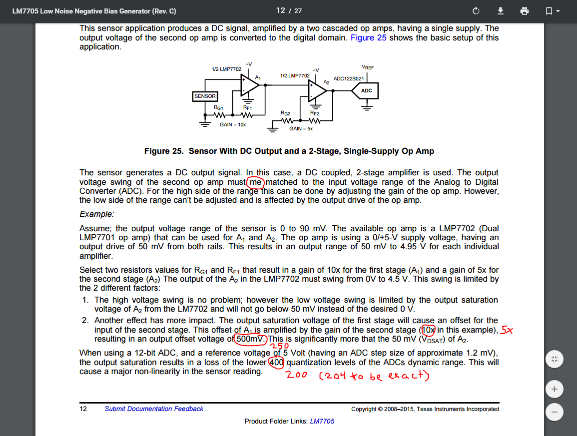

LM7705: Documentation errors in rev. C datasheet
Part Number: LM7705
Hmm, I'm not so sure this document was ever proofread.  See below.
Best, Matt
