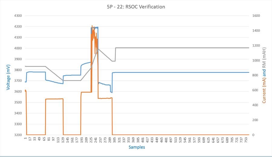

BQ24250: Being used in conjunction with BQ25892, seeing odd paterns in battery level
Part Number: BQ24250
Other Parts Discussed in Thread: BQ25892,
Team,
I have a customer that is using a BQ25892 in conjunction with a BQ2425x battery charging system. They are seeing odd jumps in the measured battery percentage, so this was originally taken up with the fuel gauge group, but we wanted to verify the charging on your end as well. Could you have a look at the attached plot and logs and see if anything jumps out at you as incorrect?
	Line 1342: [Wed Feb 01 20:55:17.027 2017]  << Bat Char [43%] Bat Temp [28.25] V[3796] C[0] FCC[3332] RM [1416] Avg Pow[0] >>
	Line 1362: [Wed Feb 01 20:55:18.774 2017]  << Bat Char [43%] Bat Temp [28.25] V[3795] C[0] FCC[3332] RM [1416] Avg Pow[0] >>
	Line 1381: [Wed Feb 01 20:55:21.785 2017]  << Bat Char [43%] Bat Temp [28.15] V[3795] C[0] FCC[3332] RM [1416] Avg Pow[0] >>
	Line 1400: [Wed Feb 01 20:55:24.780 2017]  << Bat Char [43%] Bat Temp [28.15] V[3794] C[0] FCC[3332] RM [1416] Avg Pow[0] >>
	Line 1419: [Wed Feb 01 20:55:27.775 2017]  << Bat Char [43%] Bat Temp [28.15] V[3794] C[0] FCC[3332] RM [1416] Avg Pow[0] >>
	Line 1438: [Wed Feb 01 20:55:30.770 2017]  << Bat Char [43%] Bat Temp [28.15] V[3793] C[0] FCC[3332] RM [1416] Avg Pow[0] >>
	Line 1457: [Wed Feb 01 20:55:33.781 2017]  << Bat Char [43%] Bat Temp [28.15] V[3793] C[0] FCC[3332] RM [1416] Avg Pow[0] >>
	Line 1476: [Wed Feb 01 20:55:36.792 2017]  << Bat Char [43%] Bat Temp [28.15] V[3793] C[0] FCC[3332] RM [1416] Avg Pow[0] >>
	Line 1495: [Wed Feb 01 20:55:39.772 2017]  << Bat Char [43%] Bat Temp [28.15] V[3792] C[0] FCC[3332] RM [1416] Avg Pow[0] >>
	Line 1514: [Wed Feb 01 20:55:42.782 2017]  << Bat Char [43%] Bat Temp [28.15] V[3792] C[0] FCC[3332] RM [1416] Avg Pow[0] >>
	Line 1624: [Wed Feb 01 20:56:12.781 2017]  << Bat Char [43%] Bat Temp [28.15] V[3790] C[0] FCC[3332] RM [1416] Avg Pow[0] >>
	Line 1724: [Wed Feb 01 20:56:42.780 2017]  << Bat Char [43%] Bat Temp [28.15] V[3790] C[0] FCC[3332] RM [1416] Avg Pow[0] >>
	Line 2004: [Wed Feb 01 20:57:12.779 2017]  << Bat Char [43%] Bat Temp [28.25] V[3790] C[0] FCC[3332] RM [1416] Avg Pow[0] >>
	Line 2104: [Wed Feb 01 20:57:42.778 2017]  << Bat Char [43%] Bat Temp [28.25] V[3789] C[0] FCC[3332] RM [1416] Avg Pow[0] >>
	Line 2204: [Wed Feb 01 20:58:12.777 2017]  << Bat Char [43%] Bat Temp [28.35] V[3788] C[0] FCC[3332] RM [1416] Avg Pow[0] >>
	Line 2304: [Wed Feb 01 20:58:42.775 2017]  << Bat Char [43%] Bat Temp [28.45] V[3788] C[0] FCC[3332] RM [1416] Avg Pow[0] >>
	Line 2461: [Wed Feb 01 20:59:12.774 2017]  << Bat Char [43%] Bat Temp [28.55] V[3788] C[0] FCC[3332] RM [1416] Avg Pow[0] >>
	Line 2564: [Wed Feb 01 20:59:42.773 2017]  << Bat Char [43%] Bat Temp [28.65] V[3788] C[0] FCC[3332] RM [1416] Avg Pow[0] >>
	Line 2664: [Wed Feb 01 21:00:12.772 2017]  << Bat Char [43%] Bat Temp [28.65] V[3788] C[0] FCC[3332] RM [1416] Avg Pow[0] >>
	Line 2764: [Wed Feb 01 21:00:42.771 2017]  << Bat Char [43%] Bat Temp [28.65] V[3788] C[0] FCC[3332] RM [1416] Avg Pow[0] >>
	Line 2894: [Wed Feb 01 21:01:12.770 2017]  << Bat Char [43%] Bat Temp [28.75] V[3787] C[0] FCC[3332] RM [1416] Avg Pow[0] >>
	Line 3184: [Wed Feb 01 21:01:42.769 2017]  << Bat Char [43%] Bat Temp [28.85] V[3787] C[0] FCC[3332] RM [1416] Avg Pow[0] >>
	Line 3344: [Wed Feb 01 21:02:12.767 2017]  << Bat Char [43%] Bat Temp [28.95] V[3787] C[0] FCC[3332] RM [1416] Avg Pow[0] >>
	Line 3499: [Wed Feb 01 21:02:42.766 2017]  << Bat Char [43%] Bat Temp [29.05] V[3787] C[0] FCC[3332] RM [1416] Avg Pow[0] >>
	Line 3659: [Wed Feb 01 21:03:12.765 2017]  << Bat Char [43%] Bat Temp [29.15] V[3787] C[0] FCC[3332] RM [1416] Avg Pow[0] >>
	Line 3819: [Wed Feb 01 21:03:42.764 2017]  << Bat Char [43%] Bat Temp [29.15] V[3787] C[0] FCC[3332] RM [1416] Avg Pow[0] >>
	Line 3979: [Wed Feb 01 21:04:12.778 2017]  << Bat Char [43%] Bat Temp [29.25] V[3787] C[0] FCC[3332] RM [1416] Avg Pow[0] >>
	Line 4139: [Wed Feb 01 21:04:42.777 2017]  << Bat Char [43%] Bat Temp [29.35] V[3787] C[0] FCC[3332] RM [1416] Avg Pow[0] >>
	Line 4295: [Wed Feb 01 21:05:12.761 2017]  << Bat Char [43%] Bat Temp [29.35] V[3787] C[0] FCC[3332] RM [1416] Avg Pow[0] >>
	Line 4455: [Wed Feb 01 21:05:42.775 2017]  << Bat Char [43%] Bat Temp [29.45] V[3787] C[0] FCC[3332] RM [1416] Avg Pow[0] >>
	Line 4615: [Wed Feb 01 21:06:12.774 2017]  << Bat Char [43%] Bat Temp [29.45] V[3787] C[0] FCC[3332] RM [1416] Avg Pow[0] >>
	Line 4901: [Wed Feb 01 21:06:42.773 2017]  << Bat Char [43%] Bat Temp [29.55] V[3787] C[0] FCC[3332] RM [1416] Avg Pow[0] >>
	Line 5061: [Wed Feb 01 21:07:12.772 2017]  << Bat Char [43%] Bat Temp [29.55] V[3787] C[0] FCC[3332] RM [1416] Avg Pow[0] >>
	Line 5221: [Wed Feb 01 21:07:42.786 2017]  << Bat Char [43%] Bat Temp [29.65] V[3787] C[0] FCC[3332] RM [1416] Avg Pow[0] >>
	Line 5376: [Wed Feb 01 21:08:12.769 2017]  << Bat Char [43%] Bat Temp [29.75] V[3786] C[0] FCC[3332] RM [1416] Avg Pow[0] >>
	Line 5536: [Wed Feb 01 21:08:42.768 2017]  << Bat Char [43%] Bat Temp [29.75] V[3787] C[0] FCC[3332] RM [1416] Avg Pow[0] >>
	Line 5696: [Wed Feb 01 21:09:12.767 2017]  << Bat Char [43%] Bat Temp [29.85] V[3786] C[0] FCC[3332] RM [1416] Avg Pow[0] >>
	Line 5856: [Wed Feb 01 21:09:42.766 2017]  << Bat Char [43%] Bat Temp [29.85] V[3786] C[0] FCC[3332] RM [1416] Avg Pow[0] >>
	Line 6016: [Wed Feb 01 21:10:12.765 2017]  << Bat Char [43%] Bat Temp [29.95] V[3787] C[0] FCC[3332] RM [1416] Avg Pow[0] >>
	Line 6176: [Wed Feb 01 21:10:42.764 2017]  << Bat Char [43%] Bat Temp [29.95] V[3787] C[0] FCC[3332] RM [1416] Avg Pow[0] >>
	Line 6336: [Wed Feb 01 21:11:12.794 2017]  << Bat Char [43%] Bat Temp [30.15] V[3786] C[0] FCC[3332] RM [1416] Avg Pow[0] >>
	Line 6619: [Wed Feb 01 21:11:42.761 2017]  << Bat Char [43%] Bat Temp [30.15] V[3786] C[0] FCC[3332] RM [1416] Avg Pow[0] >>
	Line 6779: [Wed Feb 01 21:12:12.760 2017]  << Bat Char [43%] Bat Temp [30.25] V[3786] C[0] FCC[3332] RM [1416] Avg Pow[0] >>
	Line 6939: [Wed Feb 01 21:12:42.759 2017]  << Bat Char [43%] Bat Temp [30.25] V[3787] C[0] FCC[3332] RM [1416] Avg Pow[0] >>
	Line 7099: [Wed Feb 01 21:13:12.758 2017]  << Bat Char [43%] Bat Temp [30.35] V[3786] C[0] FCC[3332] RM [1416] Avg Pow[0] >>
	Line 7259: [Wed Feb 01 21:13:42.757 2017]  << Bat Char [43%] Bat Temp [30.25] V[3786] C[0] FCC[3332] RM [1416] Avg Pow[0] >>
	Line 7419: [Wed Feb 01 21:14:12.787 2017]  << Bat Char [43%] Bat Temp [30.35] V[3786] C[0] FCC[3332] RM [1416] Avg Pow[0] >>
	Line 7574: [Wed Feb 01 21:14:42.754 2017]  << Bat Char [43%] Bat Temp [30.35] V[3786] C[0] FCC[3332] RM [1416] Avg Pow[0] >>
	Line 7734: [Wed Feb 01 21:15:12.753 2017]  << Bat Char [43%] Bat Temp [30.45] V[3786] C[0] FCC[3332] RM [1416] Avg Pow[0] >>
	Line 7894: [Wed Feb 01 21:15:42.768 2017]  << Bat Char [43%] Bat Temp [30.55] V[3786] C[0] FCC[3332] RM [1416] Avg Pow[0] >>
	Line 8054: [Wed Feb 01 21:16:12.767 2017]  << Bat Char [43%] Bat Temp [30.65] V[3786] C[0] FCC[3332] RM [1416] Avg Pow[0] >>
	Line 8334: [Wed Feb 01 21:16:42.765 2017]  << Bat Char [43%] Bat Temp [30.65] V[3786] C[0] FCC[3332] RM [1416] Avg Pow[0] >>
	Line 8489: [Wed Feb 01 21:17:12.764 2017]  << Bat Char [43%] Bat Temp [30.65] V[3786] C[0] FCC[3332] RM [1416] Avg Pow[0] >>
	Line 8649: [Wed Feb 01 21:17:42.763 2017]  << Bat Char [43%] Bat Temp [30.75] V[3786] C[0] FCC[3332] RM [1416] Avg Pow[0] >>
	Line 8809: [Wed Feb 01 21:18:12.762 2017]  << Bat Char [43%] Bat Temp [30.75] V[3786] C[0] FCC[3332] RM [1416] Avg Pow[0] >>
	Line 8969: [Wed Feb 01 21:18:42.761 2017]  << Bat Char [43%] Bat Temp [30.85] V[3786] C[0] FCC[3332] RM [1416] Avg Pow[0] >>
	Line 9129: [Wed Feb 01 21:19:12.760 2017]  << Bat Char [43%] Bat Temp [30.85] V[3786] C[0] FCC[3332] RM [1416] Avg Pow[0] >>
	Line 9289: [Wed Feb 01 21:19:42.758 2017]  << Bat Char [43%] Bat Temp [30.95] V[3786] C[0] FCC[3332] RM [1416] Avg Pow[0] >>
	Line 9449: [Wed Feb 01 21:20:12.773 2017]  << Bat Char [43%] Bat Temp [30.95] V[3786] C[0] FCC[3332] RM [1416] Avg Pow[0] >>
	Line 9604: [Wed Feb 01 21:20:42.756 2017]  << Bat Char [43%] Bat Temp [31.05] V[3786] C[0] FCC[3332] RM [1416] Avg Pow[0] >>
	Line 9764: [Wed Feb 01 21:21:12.755 2017]  << Bat Char [43%] Bat Temp [31.05] V[3786] C[0] FCC[3332] RM [1416] Avg Pow[0] >>
	Line 10050: [Wed Feb 01 21:21:42.754 2017]  << Bat Char [43%] Bat Temp [31.15] V[3786] C[0] FCC[3332] RM [1416] Avg Pow[0] >>
	Line 10210: [Wed Feb 01 21:22:12.753 2017]  << Bat Char [43%] Bat Temp [31.15] V[3786] C[0] FCC[3332] RM [1416] Avg Pow[0] >>
	Line 10370: [Wed Feb 01 21:22:42.752 2017]  << Bat Char [43%] Bat Temp [31.25] V[3786] C[0] FCC[3332] RM [1416] Avg Pow[0] >>
	Line 10530: [Wed Feb 01 21:23:12.766 2017]  << Bat Char [43%] Bat Temp [31.25] V[3786] C[0] FCC[3332] RM [1416] Avg Pow[0] >>
	Line 10685: [Wed Feb 01 21:23:42.749 2017]  << Bat Char [43%] Bat Temp [31.35] V[3786] C[0] FCC[3332] RM [1416] Avg Pow[0] >>
	Line 10845: [Wed Feb 01 21:24:12.748 2017]  << Bat Char [43%] Bat Temp [31.35] V[3786] C[0] FCC[3332] RM [1416] Avg Pow[0] >>
	Line 11005: [Wed Feb 01 21:24:42.747 2017]  << Bat Char [43%] Bat Temp [31.35] V[3786] C[0] FCC[3332] RM [1416] Avg Pow[0] >>
	Line 11165: [Wed Feb 01 21:25:12.746 2017]  << Bat Char [43%] Bat Temp [31.45] V[3786] C[0] FCC[3332] RM [1416] Avg Pow[0] >>
	Line 11325: [Wed Feb 01 21:25:42.745 2017]  << Bat Char [43%] Bat Temp [31.45] V[3786] C[0] FCC[3332] RM [1416] Avg Pow[0] >>
	Line 11489: [Wed Feb 01 21:26:12.759 2017]  << Bat Char [43%] Bat Temp [32.45] V[3721] C[477] FCC[3332] RM [1411] Avg Pow[1775] >>
	Line 11768: [Wed Feb 01 21:26:42.758 2017]  << Bat Char [43%] Bat Temp [32.45] V[3719] C[477] FCC[3332] RM [1407] Avg Pow[1774] >>
	Line 11928: [Wed Feb 01 21:27:12.757 2017]  << Bat Char [43%] Bat Temp [32.55] V[3718] C[477] FCC[3332] RM [1402] Avg Pow[1773] >>
	Line 12088: [Wed Feb 01 21:27:42.756 2017]  << Bat Char [42%] Bat Temp [32.65] V[3717] C[477] FCC[3332] RM [1398] Avg Pow[1773] >>
	Line 12248: [Wed Feb 01 21:28:12.755 2017]  << Bat Char [42%] Bat Temp [32.65] V[3717] C[477] FCC[3332] RM [1393] Avg Pow[1773] >>
	Line 12408: [Wed Feb 01 21:28:42.753 2017]  << Bat Char [42%] Bat Temp [32.75] V[3716] C[478] FCC[3332] RM [1389] Avg Pow[1776] >>
	Line 12568: [Wed Feb 01 21:29:12.752 2017]  << Bat Char [42%] Bat Temp [32.85] V[3716] C[477] FCC[3332] RM [1384] Avg Pow[1773] >>
	Line 12723: [Wed Feb 01 21:29:42.751 2017]  << Bat Char [42%] Bat Temp [32.85] V[3715] C[477] FCC[3332] RM [1380] Avg Pow[1772] >>
	Line 12883: [Wed Feb 01 21:30:12.750 2017]  << Bat Char [42%] Bat Temp [32.85] V[3715] C[477] FCC[3332] RM [1375] Avg Pow[1772] >>
	Line 13043: [Wed Feb 01 21:30:42.749 2017]  << Bat Char [42%] Bat Temp [32.95] V[3715] C[478] FCC[3332] RM [1371] Avg Pow[1776] >>
	Line 13203: [Wed Feb 01 21:31:12.748 2017]  << Bat Char [41%] Bat Temp [32.95] V[3715] C[477] FCC[3332] RM [1366] Avg Pow[1772] >>
	Line 13487: [Wed Feb 01 21:31:42.747 2017]  << Bat Char [41%] Bat Temp [33.05] V[3714] C[477] FCC[3332] RM [1362] Avg Pow[1772] >>
	Line 13647: [Wed Feb 01 21:32:12.745 2017]  << Bat Char [41%] Bat Temp [33.05] V[3714] C[478] FCC[3332] RM [1357] Avg Pow[1775] >>
	Line 13802: [Wed Feb 01 21:32:42.744 2017]  << Bat Char [41%] Bat Temp [33.15] V[3713] C[478] FCC[3332] RM [1353] Avg Pow[1775] >>
	Line 13962: [Wed Feb 01 21:33:12.743 2017]  << Bat Char [41%] Bat Temp [33.25] V[3713] C[477] FCC[3332] RM [1348] Avg Pow[1771] >>
	Line 14122: [Wed Feb 01 21:33:42.742 2017]  << Bat Char [41%] Bat Temp [33.25] V[3713] C[478] FCC[3332] RM [1344] Avg Pow[1775] >>
	Line 14282: [Wed Feb 01 21:34:12.741 2017]  << Bat Char [41%] Bat Temp [33.25] V[3712] C[478] FCC[3332] RM [1340] Avg Pow[1774] >>
	Line 14442: [Wed Feb 01 21:34:42.740 2017]  << Bat Char [41%] Bat Temp [33.35] V[3712] C[477] FCC[3332] RM [1335] Avg Pow[1771] >>
	Line 14602: [Wed Feb 01 21:35:12.739 2017]  << Bat Char [40%] Bat Temp [33.35] V[3712] C[477] FCC[3332] RM [1331] Avg Pow[1771] >>
	Line 14762: [Wed Feb 01 21:35:42.753 2017]  << Bat Char [40%] Bat Temp [33.35] V[3712] C[478] FCC[3332] RM [1326] Avg Pow[1774] >>
	Line 14917: [Wed Feb 01 21:36:12.752 2017]  << Bat Char [40%] Bat Temp [33.45] V[3712] C[478] FCC[3332] RM [1322] Avg Pow[1774] >>
	Line 15203: [Wed Feb 01 21:36:42.751 2017]  << Bat Char [40%] Bat Temp [33.45] V[3711] C[478] FCC[3332] RM [1317] Avg Pow[1774] >>
	Line 15363: [Wed Feb 01 21:37:12.750 2017]  << Bat Char [40%] Bat Temp [33.45] V[3711] C[478] FCC[3332] RM [1313] Avg Pow[1774] >>
	Line 15523: [Wed Feb 01 21:37:42.748 2017]  << Bat Char [40%] Bat Temp [33.55] V[3711] C[478] FCC[3332] RM [1308] Avg Pow[1774] >>
	Line 15683: [Wed Feb 01 21:38:12.747 2017]  << Bat Char [40%] Bat Temp [33.55] V[3710] C[479] FCC[3332] RM [1304] Avg Pow[1777] >>
	Line 15843: [Wed Feb 01 21:38:42.762 2017]  << Bat Char [39%] Bat Temp [33.65] V[3710] C[478] FCC[3332] RM [1299] Avg Pow[1773] >>
	Line 15998: [Wed Feb 01 21:39:12.745 2017]  << Bat Char [39%] Bat Temp [33.65] V[3710] C[478] FCC[3332] RM [1295] Avg Pow[1773] >>
	Line 16158: [Wed Feb 01 21:39:42.744 2017]  << Bat Char [39%] Bat Temp [33.65] V[3710] C[479] FCC[3332] RM [1290] Avg Pow[1777] >>
	Line 16318: [Wed Feb 01 21:40:12.743 2017]  << Bat Char [39%] Bat Temp [33.75] V[3710] C[479] FCC[3332] RM [1286] Avg Pow[1777] >>
	Line 16478: [Wed Feb 01 21:40:42.741 2017]  << Bat Char [39%] Bat Temp [33.75] V[3709] C[478] FCC[3332] RM [1281] Avg Pow[1773] >>
	Line 16638: [Wed Feb 01 21:41:12.740 2017]  << Bat Char [39%] Bat Temp [33.75] V[3709] C[479] FCC[3332] RM [1277] Avg Pow[1777] >>
	Line 16920: [Wed Feb 01 21:41:42.755 2017]  << Bat Char [39%] Bat Temp [33.85] V[3708] C[479] FCC[3332] RM [1272] Avg Pow[1776] >>
	Line 17075: [Wed Feb 01 21:42:12.738 2017]  << Bat Char [39%] Bat Temp [33.85] V[3708] C[479] FCC[3332] RM [1268] Avg Pow[1776] >>
	Line 17235: [Wed Feb 01 21:42:42.737 2017]  << Bat Char [38%] Bat Temp [33.85] V[3708] C[478] FCC[3332] RM [1263] Avg Pow[1772] >>
	Line 17395: [Wed Feb 01 21:43:12.736 2017]  << Bat Char [38%] Bat Temp [33.85] V[3708] C[479] FCC[3332] RM [1259] Avg Pow[1776] >>
	Line 17555: [Wed Feb 01 21:43:42.735 2017]  << Bat Char [38%] Bat Temp [33.95] V[3707] C[479] FCC[3332] RM [1254] Avg Pow[1776] >>
	Line 17715: [Wed Feb 01 21:44:12.733 2017]  << Bat Char [38%] Bat Temp [33.95] V[3707] C[480] FCC[3332] RM [1250] Avg Pow[1779] >>
	Line 17875: [Wed Feb 01 21:44:42.732 2017]  << Bat Char [38%] Bat Temp [33.95] V[3707] C[479] FCC[3332] RM [1245] Avg Pow[1776] >>
	Line 18035: [Wed Feb 01 21:45:12.747 2017]  << Bat Char [38%] Bat Temp [34.05] V[3706] C[479] FCC[3332] RM [1241] Avg Pow[1775] >>
	Line 18190: [Wed Feb 01 21:45:42.730 2017]  << Bat Char [38%] Bat Temp [34.05] V[3705] C[480] FCC[3332] RM [1237] Avg Pow[1778] >>
	Line 18350: [Wed Feb 01 21:46:12.729 2017]  << Bat Char [37%] Bat Temp [34.05] V[3704] C[480] FCC[3332] RM [1232] Avg Pow[1778] >>
	Line 18632: [Wed Feb 01 21:46:42.743 2017]  << Bat Char [37%] Bat Temp [34.05] V[3704] C[479] FCC[3332] RM [1227] Avg Pow[1774] >>
	Line 18792: [Wed Feb 01 21:47:12.742 2017]  << Bat Char [37%] Bat Temp [34.15] V[3704] C[479] FCC[3332] RM [1223] Avg Pow[1774] >>
	Line 18952: [Wed Feb 01 21:47:42.741 2017]  << Bat Char [37%] Bat Temp [34.15] V[3703] C[480] FCC[3332] RM [1218] Avg Pow[1777] >>
	Line 19112: [Wed Feb 01 21:48:12.771 2017]  << Bat Char [37%] Bat Temp [34.15] V[3702] C[480] FCC[3332] RM [1214] Avg Pow[1777] >>

	Line 51790: [Sat Feb 04 23:45:27.152 2017]  << Bat Char [30%] Bat Temp [34.55] V[3775] C[0] FCC[3301] RM [989] Avg Pow[0] >>
	Line 52089: [Sat Feb 04 23:45:57.150 2017]  << Bat Char [30%] Bat Temp [34.55] V[3775] C[0] FCC[3301] RM [989] Avg Pow[0] >>
	Line 52255: [Sat Feb 04 23:46:27.149 2017]  << Bat Char [30%] Bat Temp [34.55] V[3775] C[0] FCC[3301] RM [989] Avg Pow[0] >>
	Line 52421: [Sat Feb 04 23:46:57.148 2017]  << Bat Char [30%] Bat Temp [34.55] V[3775] C[0] FCC[3301] RM [989] Avg Pow[0] >>
	Line 52587: [Sat Feb 04 23:47:27.163 2017]  << Bat Char [30%] Bat Temp [34.55] V[3775] C[0] FCC[3301] RM [989] Avg Pow[0] >>
	Line 52751: [Sat Feb 04 23:47:57.161 2017]  << Bat Char [30%] Bat Temp [34.55] V[3776] C[0] FCC[3301] RM [989] Avg Pow[0] >>
	Line 52917: [Sat Feb 04 23:48:27.160 2017]  << Bat Char [30%] Bat Temp [34.55] V[3776] C[0] FCC[3301] RM [989] Avg Pow[0] >>
	Line 53083: [Sat Feb 04 23:48:57.159 2017]  << Bat Char [30%] Bat Temp [34.45] V[3776] C[0] FCC[3301] RM [989] Avg Pow[0] >>
	Line 53249: [Sat Feb 04 23:49:27.158 2017]  << Bat Char [35%] Bat Temp [34.45] V[3776] C[0] FCC[3356] RM [1168] Avg Pow[0] >>
	Line 53418: [Sat Feb 04 23:49:57.157 2017]  << Bat Char [35%] Bat Temp [34.55] V[3776] C[0] FCC[3356] RM [1168] Avg Pow[0] >>
	Line 53584: [Sat Feb 04 23:50:27.156 2017]  << Bat Char [35%] Bat Temp [34.45] V[3776] C[0] FCC[3356] RM [1168] Avg Pow[0] >>
	Line 53871: [Sat Feb 04 23:50:57.186 2017]  << Bat Char [35%] Bat Temp [34.55] V[3776] C[0] FCC[3356] RM [1168] Avg Pow[0] >>
	Line 54037: [Sat Feb 04 23:51:27.153 2017]  << Bat Char [35%] Bat Temp [34.55] V[3776] C[0] FCC[3356] RM [1168] Avg Pow[0] >>
	Line 54206: [Sat Feb 04 23:51:57.152 2017]  << Bat Char [35%] Bat Temp [34.45] V[3776] C[0] FCC[3356] RM [1168] Avg Pow[0] >>
	Line 54372: [Sat Feb 04 23:52:27.151 2017]  << Bat Char [35%] Bat Temp [34.35] V[3776] C[0] FCC[3356] RM [1168] Avg Pow[0] >>
	Line 54538: [Sat Feb 04 23:52:57.150 2017]  << Bat Char [35%] Bat Temp [34.35] V[3776] C[0] FCC[3356] RM [1168] Avg Pow[0] >>
	Line 54704: [Sat Feb 04 23:53:27.149 2017]  << Bat Char [35%] Bat Temp [34.35] V[3776] C[0] FCC[3356] RM [1168] Avg Pow[0] >>
	Line 54873: [Sat Feb 04 23:53:57.148 2017]  << Bat Char [35%] Bat Temp [34.35] V[3776] C[0] FCC[3356] RM [1168] Avg Pow[0] >>
	Line 55034: [Sat Feb 04 23:54:27.146 2017]  << Bat Char [35%] Bat Temp [34.35] V[3776] C[0] FCC[3356] RM [1168] Avg Pow[0] >>
	Line 55200: [Sat Feb 04 23:54:57.145 2017]  << Bat Char [35%] Bat Temp [34.45] V[3776] C[0] FCC[3356] RM [1168] Avg Pow[0] >>
	Line 55366: [Sat Feb 04 23:55:27.144 2017]  << Bat Char [35%] Bat Temp [34.45] V[3776] C[0] FCC[3356] RM [1168] Avg Pow[0] >>
	Line 55643: [Sat Feb 04 23:55:57.517 2017]  << Bat Char [35%] Bat Temp [34.45] V[3776] C[0] FCC[3356] RM [1168] Avg Pow[0] >>
	Line 55809: [Sat Feb 04 23:56:27.142 2017]  << Bat Char [35%] Bat Temp [34.45] V[3776] C[0] FCC[3356] RM [1168] Avg Pow[0] >>
	Line 55975: [Sat Feb 04 23:56:57.141 2017]  << Bat Char [35%] Bat Temp [34.35] V[3777] C[0] FCC[3356] RM [1168] Avg Pow[0] >>
	Line 56136: [Sat Feb 04 23:57:27.140 2017]  << Bat Char [35%] Bat Temp [34.35] V[3777] C[0] FCC[3356] RM [1168] Avg Pow[0] >>
	Line 56305: [Sat Feb 04 23:57:57.138 2017]  << Bat Char [35%] Bat Temp [34.45] V[3776] C[0] FCC[3356] RM [1168] Avg Pow[0] >>
	Line 56471: [Sat Feb 04 23:58:27.137 2017]  << Bat Char [35%] Bat Temp [34.45] V[3777] C[0] FCC[3356] RM [1168] Avg Pow[0] >>
	Line 56637: [Sat Feb 04 23:58:57.152 2017]  << Bat Char [35%] Bat Temp [34.45] V[3776] C[0] FCC[3356] RM [1168] Avg Pow[0] >>
	Line 56803: [Sat Feb 04 23:59:27.151 2017]  << Bat Char [35%] Bat Temp [34.35] V[3776] C[0] FCC[3356] RM [1168] Avg Pow[0] >>
	Line 56972: [Sat Feb 04 23:59:57.149 2017]  << Bat Char [35%] Bat Temp [34.45] V[3776] C[0] FCC[3356] RM [1168] Avg Pow[0] >>
	Line 57138: [Sun Feb 05 00:00:27.148 2017]  << Bat Char [35%] Bat Temp [34.45] V[3777] C[0] FCC[3356] RM [1168] Avg Pow[0] >>
	Line 57303: [Sun Feb 05 00:00:57.147 2017]  << Bat Char [35%] Bat Temp [34.45] V[3777] C[0] FCC[3356] RM [1168] Avg Pow[0] >>
	Line 57593: [Sun Feb 05 00:01:27.146 2017]  << Bat Char [35%] Bat Temp [34.35] V[3777] C[0] FCC[3356] RM [1168] Avg Pow[0] >>
  • Hey Carolus,
    Can you provide some more information on your customer's test conditions?
    How exactly are the bq24250 and the bq25892 being used together? Is one providing the supply for the other? Are they both charging a single battery?
    What is your input voltage? Are you using a real battery for this application?
    Joel H
  • Carolus,
    In general, you can connect the BAT pins of two chargers together while they are in constant current (CC) mode but once the battery charges to VBATREG and both chargers are in constant voltage (CV) mode, you should ensure that one charger terminates well before the other (i.e. set its termination current higher or its termination voltage slightly lower).  Otherwise, you will see one charger toggle in and out of charging as it tries to terminate.
