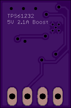

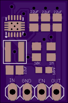

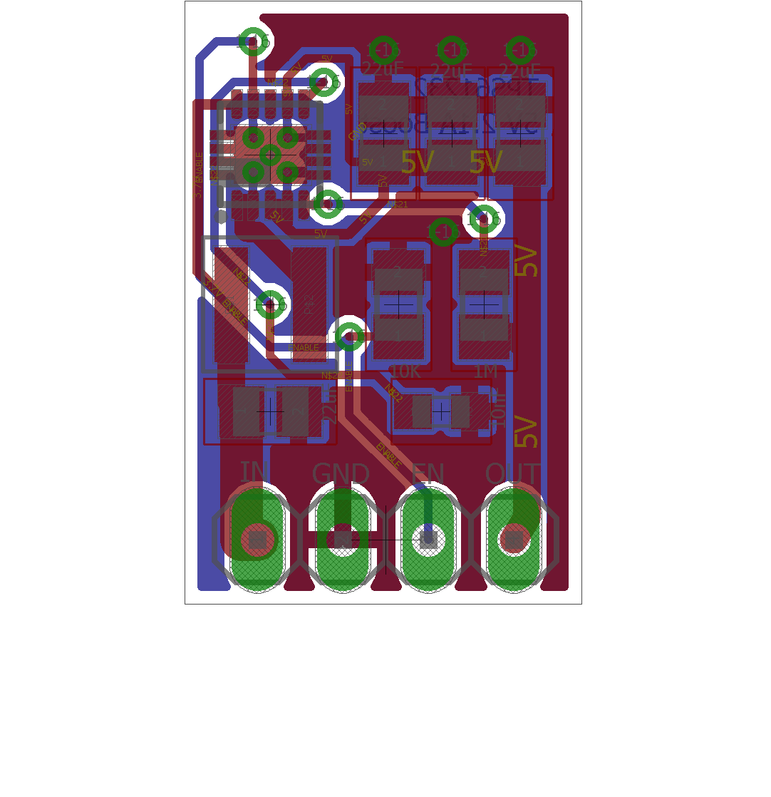

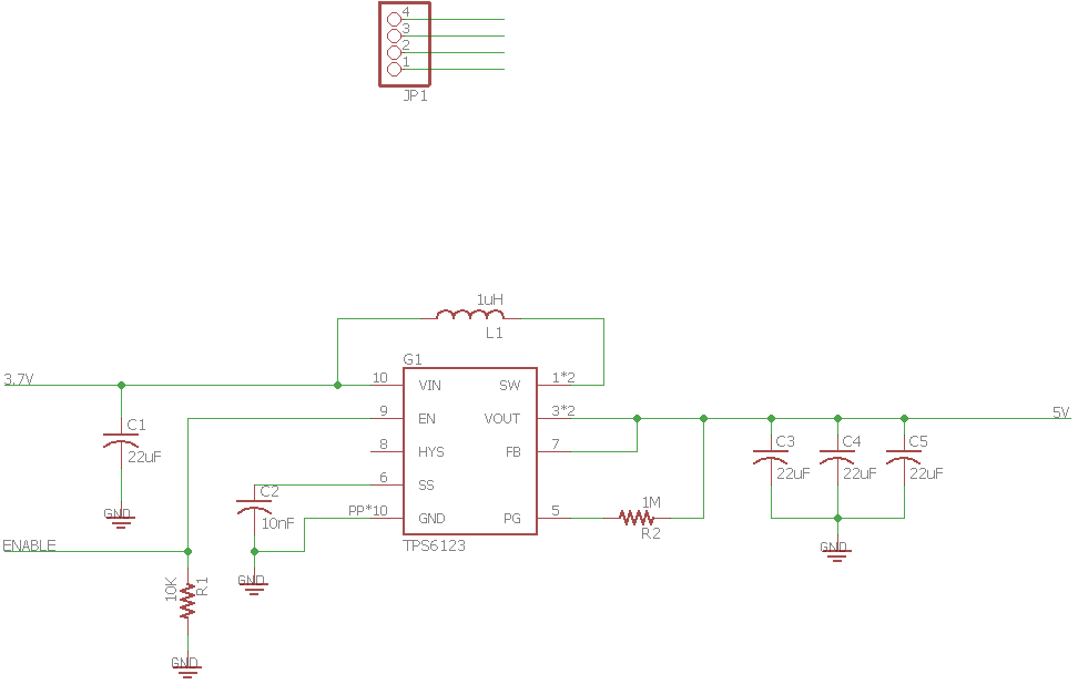

I have created a very small circuit to test out the TPS61232 and am having issues. I based my design on the reference design from the datasheet except for attaching the 'EN' pin to an input. When the circuit is connected it is giving a 3.92V output on a 4.2V input. This doesn't change if I directly ground the EN pin or bring it to Vin.
Circuit schematic:
