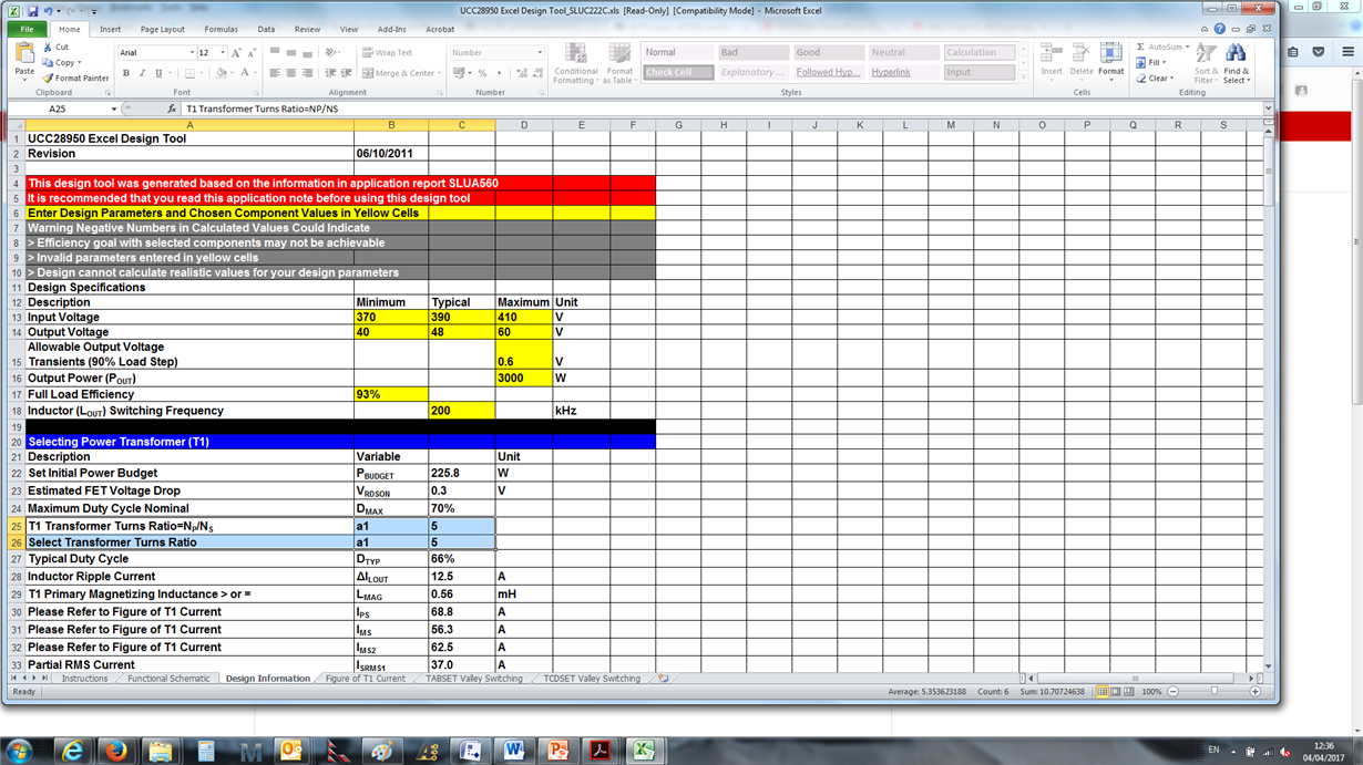

    I'm not aware of any specific Blog or Thread that tells you how to proceed - however the UCC28950 is a good choice at this power level. If you post some specifications - Vin range, Vout range etc, I can give some further guidance.
    We have both an Excel and MathCad calculator for this device. These will calculate the principle design parameters - transformer turns ratio for example. You can find them at the UCC28950 product page at http://www.ti.com/product/UCC28950/toolssoftware
    One important thing to note is that the Excel calculator rounds the turns ratio to the nearest integer. This is not actually the best thing to do. When you use the calculator, you should copy and paste the result from line 25 into line 26 rather than reading the integer value at line 25 and entering it in line 26. The copy and paste operation preserves the full decimal value of the result in line 25 - although only the integer value is actually shown. In your case, the integer is likely to be 5, but the real value is 5.35.  See the screen shot below - Please let me know if the screenshot does not appear .

  • Hello Colin,
    I downloaded the Excel file and I'm trying to use it to design values of the component to put into TINA TI schematic and then I will simulate it.
    I write you some specs of the project:
    - Vin_min = 370; Vin_typ = 390; Vin_max = 410.
    - Vout to control 56V (maximum 58V).
    - Iout 40A (maximum 50A).
    - Fswitching 70kHz.
    - Efficiency around 93-94%.
    Thank you.
