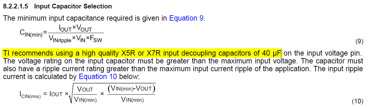

TPS568215: About input capacitor
Part Number: TPS568215
Why is the recommended value of input capacitor more than 40μF in datasheet P.21?
And what percentage of ripple to input voltage is recommended?
Could you please let us know these information because our customer want to use the input capacitor which is lower than 40 μF?
