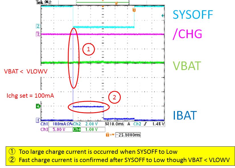

Now my customer is evaluating bq24075T EVM and then they can see unexpected behavior after SYSOFF to Low. I'd like to know this is expected behavior of bq24075T or not. This can be seen at EVM so can you try to duplicate it and give your opinion ?
  1. Too large charge current is occurred when SYSOFF to Low
  2. Fast charge current is confirmed after SYSOFF to Low though VBAT < VLOWV
