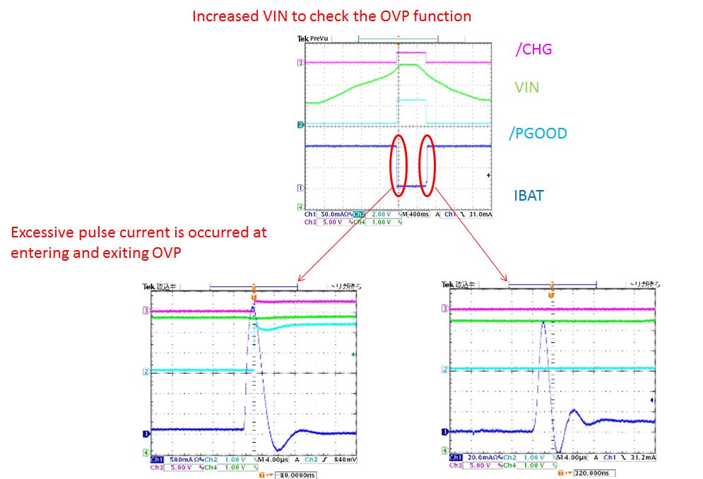

Now my customer is evaluating bq24075T EVM and then they can see excessive pulse current at input OVP . I'd like to know this is expected behavior of bq24075T or not. This can be seen at EVM so can you try to duplicate it and give your opinion ?
