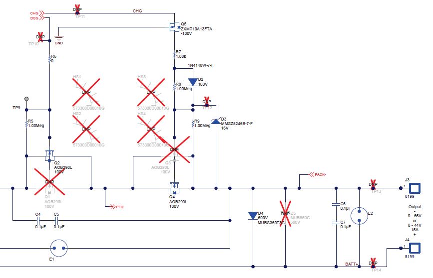

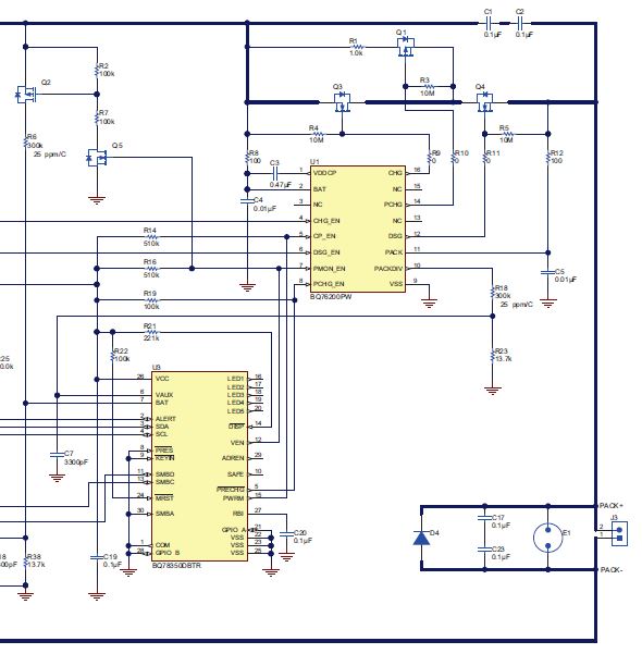

By looking to several reference schematics, I can see there are always two pairs of capacitors:
  • in parallel to output terminals
  • bridging MOS
That's for both architectures, with and without the BQ76200. Here some examples:
SLVA729A: C1-C2 and C17-C23 pairs
SLVU925B: C4-C5 and C6-C7 pairs
What is the purpose of such capacitor pairs?
We don't have them in my circuits, so we would like to better understand if we have to add them in our new designs.
Thank you and best regards
Matteo
  • Sorry, maybe schematic drawings are not been properly loaded in previous post. I add more references:
    SLVA729A, Fig.1 on page 4: C1-C2 and C17-C23 pairs
    SLVU925B, Fig.26 on page 44: C4-C5 and C6-C7 pairs
    Thank you again
    Matteo
  • The capacitor pairs are for ESD protection. They provide a low impedance path between the pack terminals and past the FETs. 2 capacitors are used in series so that they do not form a single point failure at assembly or in service. The 2 caps in the pair will commonly be oriented at right angles so they experience different mechanical stress. Search the web, check references, or refer to your capacitor supplier for capacitor failure information.
