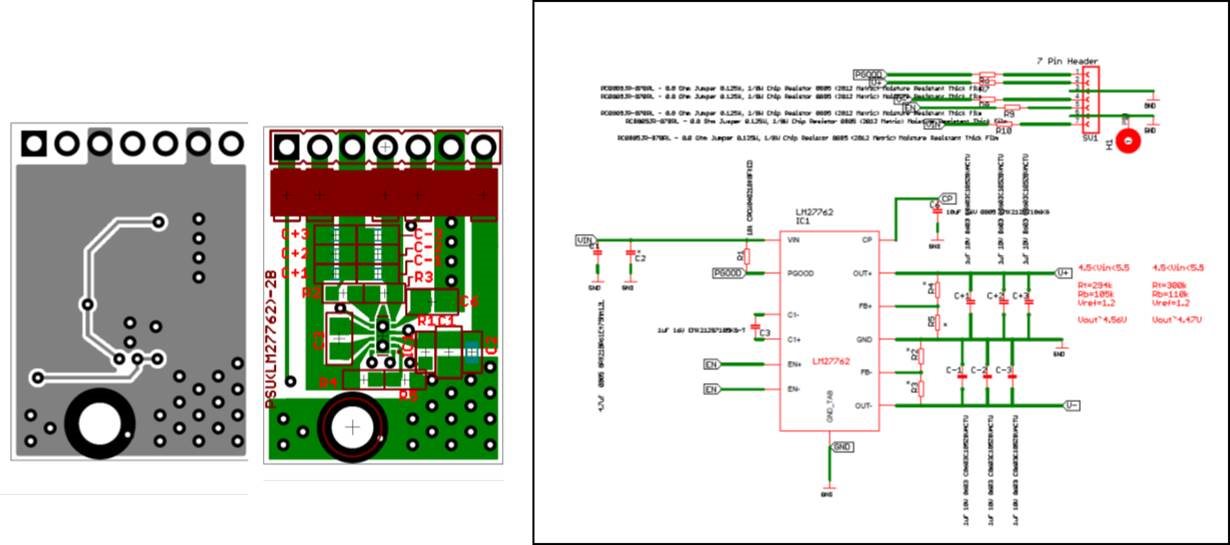

I have been having similar issues to this post (e2e.ti.com/.../582389 ). My question is that I have connected the GND pin to the thermal pad, which is obviously a very close trace. The attached diagram shows that the thermal pad has two vias to the ground plane on the bottom layer. My question is - even though my trace from the ground pin out to the Cout capacitor is long and narrow, shouldn't the thermal pad via's do the trick for avoiding this inductance issue? If so, what else could cause startup issues for this chip?
My design allows either a ~4.8V USB source or a 5VDC source form a voltage regulator. The USB connection starts up without issue, yet the 5V source always starts up in a fault state with the negative output being much too low and the circuit ringing. If I start up with the USB source and then transfer to the 5VDC source without power interruption the circuit runs fine. As well, I can short the negative output momentarily and then the circuit will run fine once I remove the short.

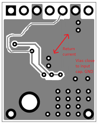

  • Hi Mory,
    The link you are referring to seems to not work anymore, but I assume it was about similar start-up issue you are describing in your post.
    You are correct in that the trace from ground plane is short as you have two vias in thermal pad and GND pin is connected to thermal pad. You have also two vias close to GND pin of output capacitor (C6). Is this 2-layer PCB? I am not sure, but it looks like there is no solid GND plane between those groups of vias. If this is true, then return current from output capacitor has to go long way around PCB.  There is also trace between GND pin and capacitor on the top layer, but that seems to be too long. Can you share the picture of bottom layer?
    The fact that it works with lower Vin makes sense as the rush current at start-up is smaller with low Vin.
    Juha
  • Juha,
    See both layers below. Note that there are two header pins for ground and they are connect on the main board that this test board connects to.

  • Thanks for the layout images. See my proposal below:
    - I would re-route one track (enable I guess)
    -I would add vias next to input capacitors to GND plane.
    -I would also move C6 closer to LM27762. You can remove GND trace on top layer between LM27762's GND pin and C6's GND terminal as there is connection to GND plane anyway.

  • Here is version 2 of my PCB layout. Still having startup issue with negative side. Seems to startup ok a bit more often then the first version, but still happening.
    Any ideas?
  • Hi Mory,
    Your layout looks much better now. I can't see capacitor values in schematics - text is so small. Do you have BOM? I am also interested in  exact type of capacitors you have used.

    Sorry for late reply. Your components seem to be ok. If you are willing to try yet another layout modification, you can try rotating input caps C1 and C2 and charge pump output capacitor C6 so that their ground pins join already in top layer. then connect that node with several vias to GND plane. That should improve situation further.
