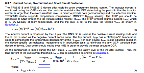

TPS53319: [HELP]The difference between Iind(peak) and Iocp
Part Number: TPS53319
