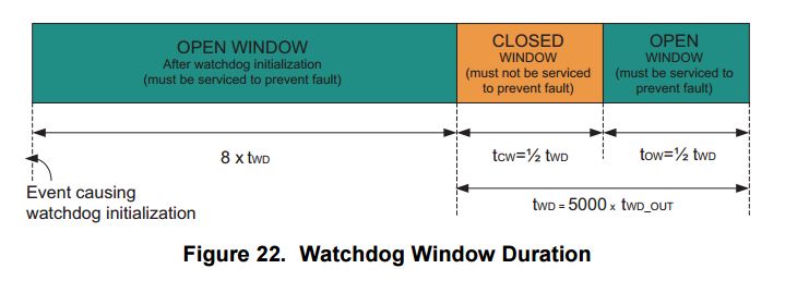

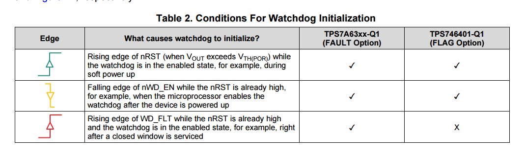

Hi Masami,
The timer is initialized by the conditions listed in Table 2.
The watchdog circuit is considered digital and is initialized at the time of the event that caused the initialization. After the event causing initialization occurs, the first WD pulse must occur within 8 x twd.
Very Respectfully,
Ryan

Hi Masami-san,
Okay, I think I understand what you are looking for now. You are looking for the time from the watchdog being disabled (nWD_EN going logic high) to the watchdog fault clearing. This time should be less than 1.65us.
Very Respectfully,
Ryan
