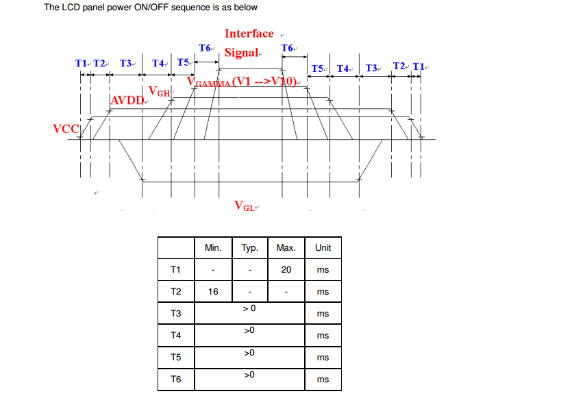

Below is customer panel power sequence spec. of LSA40AT9001. TPS65150 can not meet panel spec. so they need to delay DLY1 and DLY2 timing as below. What delay time we can setup and has any limit by td(DLY1) and td(DLY2) ? Thank you.
