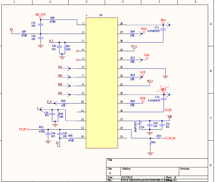

  I am using SM72295 for a solar MPPT Charger. Our is referenced from TI reference design TIDA-00120.
 The problem is No MOSFET is getting driving pulse. LOA & LOB are at 0V, HOA & HOB are at around 12V i.e  at HSA & HSB potential.
 Please help me to find the points of mistakes I may be making.

    May I get the your schematic?
    I am sure you must have checked it but please make sure that none of protections are kicking-in and all the threshold requirements are met. All the amplifier inputs are outputs need to be terminated properly.
    If you are not using the TIDA design as it is, would you please share the differences?
    Let us start with this and work toward the solution.
    Ritesh

  • Dear Ritesh,
    Please have a cross check on it. Please let me know if any modification required.
  • Hi Aamar,
    Thanks for the patience. I noticed that the pin 5, which is AGND pin, is left open. It must be tied to analog ground.

    As there is a bootstrap supply involved, low side output has to come first to charge the bootstrap capacitor so that high side bias is available to turn the high side output ON.
    Also did you check pin 15 to see if it is in OVP mode?
    Check voltage on pin 16 to make sure that the voltage is below shutdown voltage.
    Rest of the schematic looks normal.
    Let us try these and then we will move on. Most probably grounding pin 5 should solve the issue.

  • Hi Ritesh,
    We had corrected PIN5 connections to Ground before testing. We have disconnected R43 to avoid OVP shutdown, But still it is not working.
    What can be the other causes?
