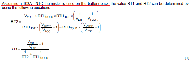

    While the device is optimized to operate with a 103AT thermistor, like mentioned, it might be possible to use a different value thermistor.
    The values for the 2 resistors in the TS network would need to be re-calculated using the new thermistor's nominal impedance (150kOhms) and its impedance at the desired Cold/Hot thresholds using the formulas provided in the datasheet.
    We also have a spreadsheet calculator tool that helps calculate these values.

    Is there any concern if my customer use the following equation with the thermistor other than 103AT-2?
    My customer wants to know if there is.
    Yaita
