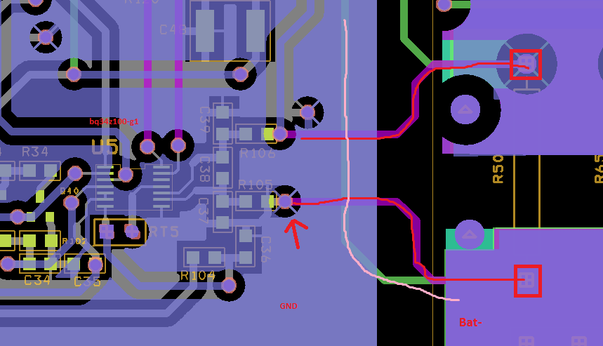

I have connected 10 parallel 5miiliohm sense resistors, making 500microohm sense for in bq34z100-g1 circuit.
After current calibration in bq34z100-g1, the value of CC Gain & CC Delta comes out to be 18.219 miiliohm. I have used current divider of 5, so as actual current was -1000mA, I had entered -200mA.
Query is actual sense is 500microohm, while after calibration it appears to be so high? I am using divider of 5, so according to be after calibration value should be around 500microohm*5 = 2.5miiliohm, somewhere near it.
But it comes out to be 18.219 miiliohm.
Is there anything I am doing wrong?
  • That does look like something is wrong. The CC Gain and CC Delta should be close to 2.5 mohm. How are the resistors connected together? There must be a connection problem or connection resistance in the network.

    1. I have two board, one is complete soldered with all sense resistors & one board with only bq34z100-g1 with single sense. Both have this problem, actual sense & CC gain are very apart after calibration. Single sense is 5milliohm.
    2. I have passed certain current though board & check voltage drop directly across sense, it seems ok. That means sense value is ok.
    3. In attached pic:
    a) Two red rectangle is where sense is connected
    b) two red wires , drawn loosely over gerber, shows the sense resistor connection to R106 & R105, which goes to U5 i.e bq34z100-g1.
    c) One pink wire, drawn loosely over gerber, shows the single point connection going from bat- to cell most negative.
    d) There is also Gnd plane as mentioned in red over gerber, which is Bat0. Bat0 is lower current return path. Bat- is high current return path. Bat- & Bat0 are connected together on top with pink loose wire, not shown in pic.
    4. What I doubt I have shorted R105 to Gnd plane(Bat0) also as shown by arrow mark. I should not connect it there, rather let that pink wire do connection between Bat- & Bat0/Gnd path.
    I suspect that because when I passed current, & measure voltage drop across R105(red arrow) & Bat-, there is some voltage drop across it, which I think should be zero, as both are shorted together. What's happening at the moment is return current flows from Bat- through lower red loose wire to R105 point where red arrow is shown then it goes to gnd, which causes the drop & gives error in calibration.
    What do you think, could it be source of error?
    Tomorrow I will test that & let you know. Today I got late while I was testing. In the end I found only this error.
    Any other error reason you expect?
    @Terry_Chen , multiple sense are connected since max continuous current is 100A & peak is 150A.
  • It was layout issue, I have cut those tracks & make wire jumpers.
