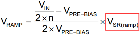

This question is about dataseet p.32  formula(22).
     Vramp={Vin/(2 x n)-Vpre-bias} / (2 x Vpre-bias ) x Vsr(ramp)
Please tell me the optimum voltage of Vpre-bias under the following conditions.
    Vin=180~210
    Vout=125
   Iout=1.6A

    The the highest pre-bias start-up voltage required by the system, genernally 90% of output voltage but it depends on the customer.

    I have a question about the formula (29).
    You said Vpre-bias is 90% of output voltage.
    Vpre-bias=125(Vout)×90%
    =112.5
      (29) VRAMP= {Vin / (2×n)‐V_PRE-BIAS} / (2×V_PRE-BIAS)×VSR_(ramp)
            = {180 / (2×0.385)‐112.5} / (2×112.5)×3
    =(233.7-112.5) / 675
    =121.2 / 675
    =0.1795
    Is the calculation formula correct?
    Nishizawa
  • Please notice the VSR(RAMP) is the numerator, the calculated results should be ~1.62V based on your parameters, please double check.
