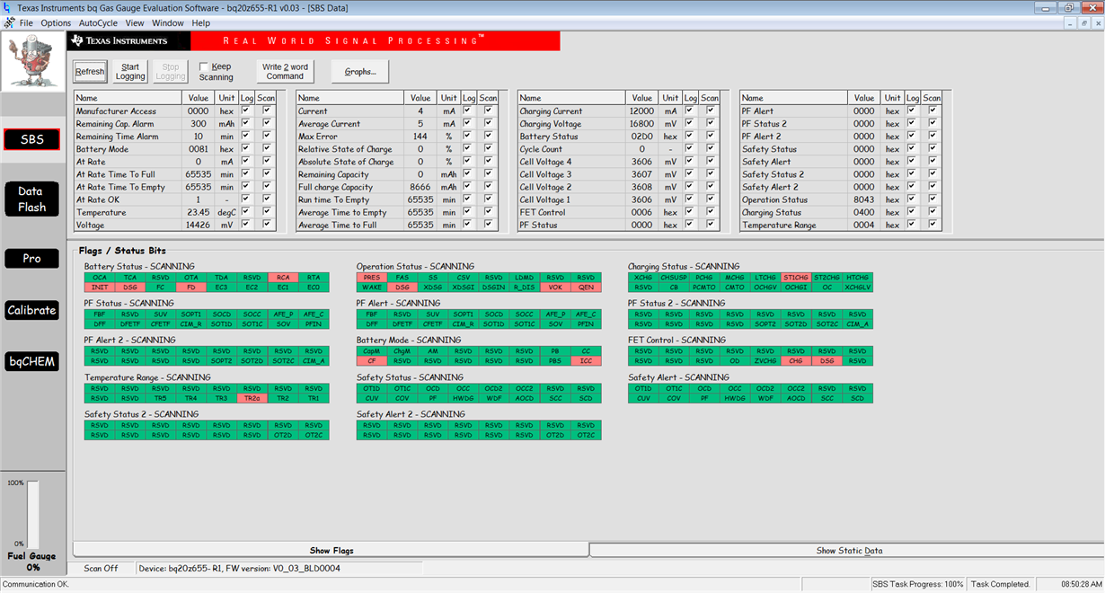

  • Hi Terry,
    Thank you for the info. There are No PF flags set. See attached image of SBS.
  • Hi Tom,
    Thanks for the sanity check. I believe I have found a portion of my design that wasn't allowing current to go low enough (despite the eqSW showing single digit mA draw...). But I think I still have two separate issues going on.
    I see the CHG FET turn off but not DSG.. Am I reading SLUU493a correctly:
    "On entry to sleep, if [NR] = 0, the CHG and DSG FETs are turned off, and the ZVCHG FET is turned off...If [NR] = 1, the CHG FET is turned off, and the ZVCHG FET is turned off"
    My design has the PRES pin hardwired to low to allow for normal FET operation. It now seems that PRES must be floating to be in Sleep mode...
    When I physically float (lift) the PRES pin and [NR] = 1, CHG turns off but DSG does not sleep.
    When I physically float (lift) the PRES pin and change [NR] = 0 to get DSG FET to turn off (to meet the above criteria from SLUU493a) in sleep mode, I cannot get the FETs to function normally. Even after sending a x21 to manufacturer access.
    Is it possible to have [NR] = 1, PRES = low and CHG/DSG go to sleep?!
