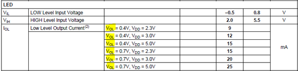

Could you tell me VOL(min max typ) of LED0-LED7?
Customers want to use that value to calculate the LED's current limit resistor.
Data sheet has only the following description.
Could you give me your advice?
Yusuke/Japan Disty

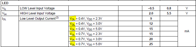

Yusuke/Japan Disty

・You taught me "Rdson of the output stage is 0.7/0.025=28R".
Does this Rdson mean current limit resistor?
・Customer is trying to use LP3944 under the condition of VDD<VLED.
(VDD=3.3V,LED voltage=5V)
Do you have a problem with this?
Yusuke/Japan Disty
Hi Yusuke-San,
If VDD=5V, VLED=3.3V, LED current is 20mA.
So current limit resistor will be (5-3.3)/0.02-28=85-28=57R.
Any other question please let me know.
Thanks!
Summer
