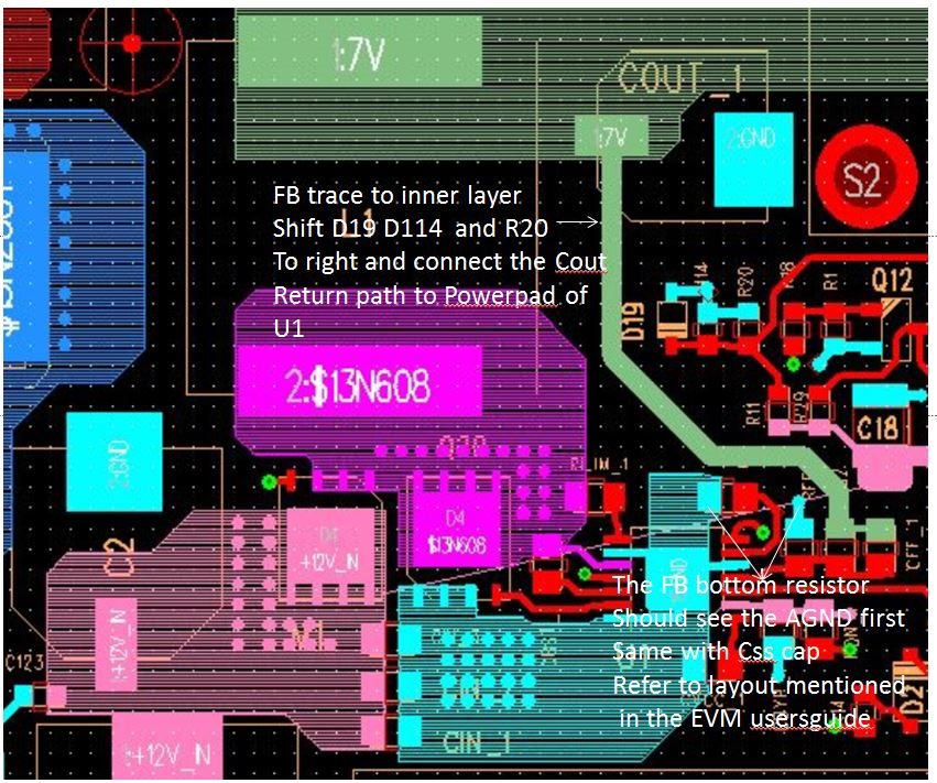

    2. Verify the Layout .Make sure that the SGND and PGND is isolated and SGND is connected to PGND at on one point only . Please refer to datasheet and EVM User guide for more details . May be in your design the Switch noise is coupling to the SGND and causing unstable this behavior .
    Further if after trying the above mentioned steps , you are not able to fix this , i would suggest you to buy one EVM of LM3150 , make changes as per your requirement and evaluate the design .Once evaluation is done you can replicate the EVM layout in your design .

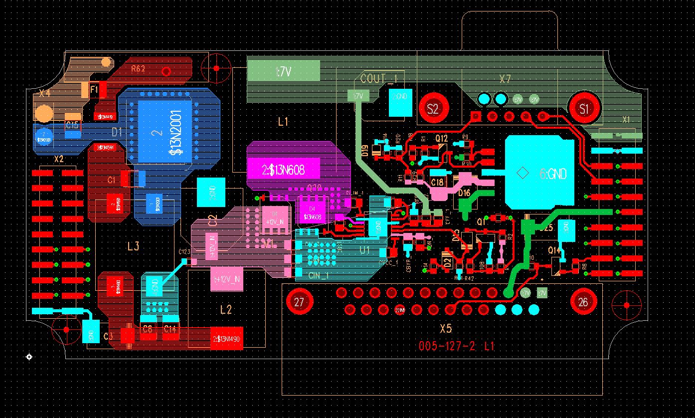

    Please see also a picture with the PCB layout. The PCB has 4 layers and there is a full GND inner layer.
    Mihai

    On the layout side , below are my recommendations :
    ---Ambreesh

    Regarding the layout issues - do you believe the points that you mentioned above would justify this behavior of the converter ?
    Mihai
  • Hi Mihai ,
    My suggestion would be get an EVM , replace the power components that are needed to be changed as per your design requirements and test out the performance .
    This way you would eliminate the issue of the layout and once the design is verified , you could follow the layout of the EVM in your design .
    ---Ambreesh
