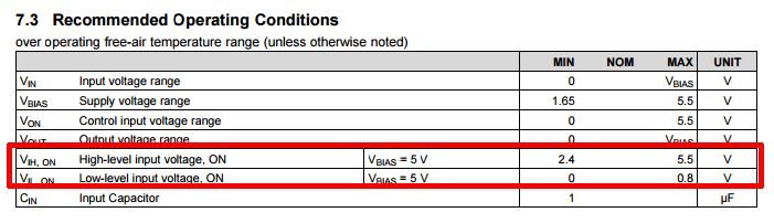

I received the following question from my customer.
Recommended Operating Conditions VIH/IL(VBIAS=5V) is mentioned in the datasheet as follows
Could you tell me the it on the VBIAS≦2.4V condition?

Hi Kuramochi,
Please find the VIH and VIL values for VBIAS=2.5V and VBIAS=1.8V in the table below:
| VBIAS | VIL | VIH |
| 2.5V | 0.6V | 1.8V |
| 1.8V | 0.6V | 1.5V |
