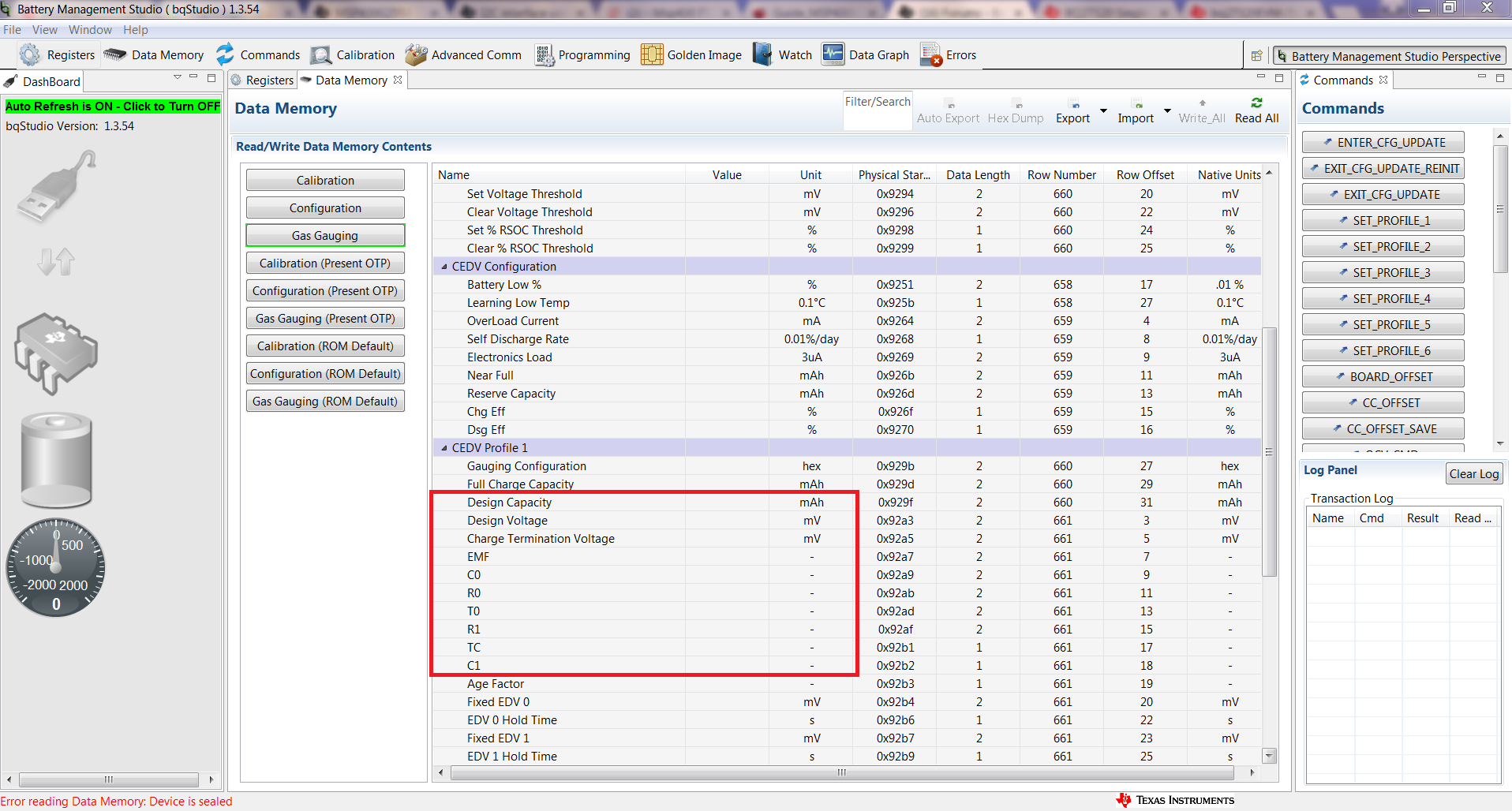

  • Hi Abhishek,
    After submitting the six log files along with config.txt file to our GPCCEDV tool you will getting an email with a report containing CEDV parameters you need to set in bq27220 data memory then your gauge can accurately gauge your battery. Please find attached sample report similar to what you wold get:
    GPC_input_data_good-report_sample.zip
    The report will have two txt files; first is GPC_CEDV.txt where you will find calculated CEDV parameters, second is OCV11.txt where you will find calculated SOC % vs batter voltage. These calculated parameters need to be updated in bq27220 data memory, please find screen shots of where you can find such parameters:
    Remember to send UNSEAL then UNSEAL_FULL_ACCESS commands before updating data memory parameters and after finished updating parameters please send ENTER_CFG_UPDATE then EXIT_CFG_UPDATE commands for updates to take place.
