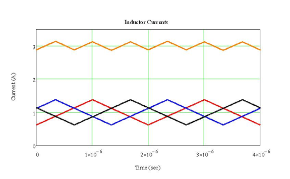

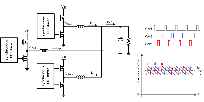

3. Why do we use the multi-phase power supply?
Increasing the switching frequency of a singla-phase buck converter has some benefits, such as improved dynamic response, reduced output ripple, and smaller inductor size. However, the efficiency decreases because switching losses increase with frequency. The selection of output inductor and power dissipation increasingly become an issue at higher current, especially when used in size constraint application.
To solve this dilemma, multi-phase power supply are thus developed. The idea of a multi-phase buck regulator is to put several buck regulators in parallel but have them operate in an interleaving manner. See figure below. The three-phase synchronous buck regulator has identical components for each phase, but the switching actions are 120 degrees out of phase.
A multi-phase power supply provides a method of increasing output current without sacrificing efficiency and switching frequency. Other advantages of this solution include reduced input and output capacitor RMS currents; reduced EMI filtering requirements; lower profile and decreased PCB real estate solution size; better thermal and forced convection performance; improved reliability and power stage redundancy; and easier power train component selection.

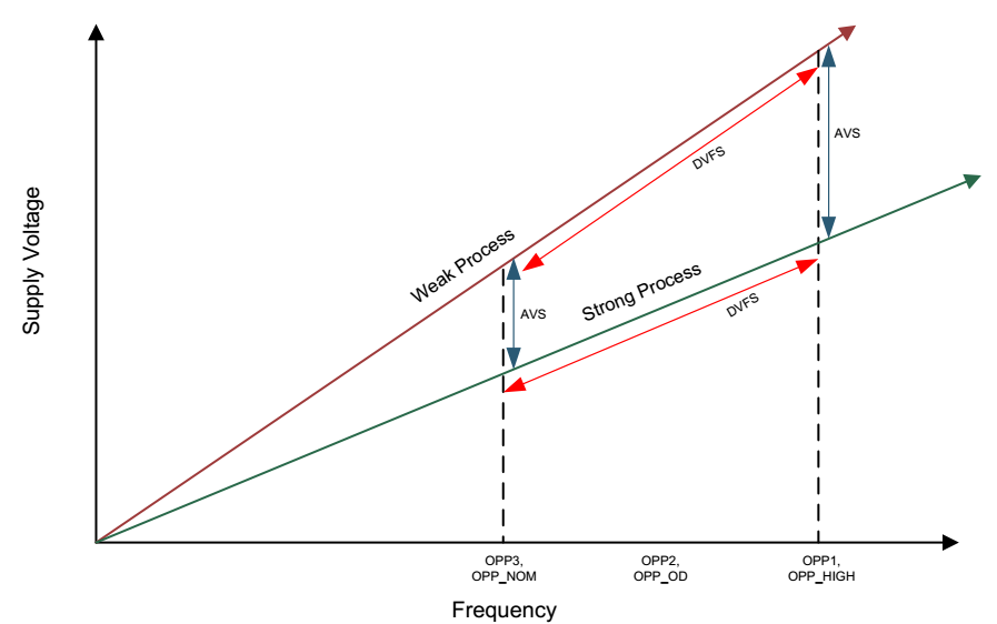

4. What is the difference between AVS (adaptive voltage scaling) and DVS (dynamic voltage scaling)?
Adaptive voltage scaling (AVS): The processor's minimum supply voltage at a specific frequency varies because of the manufacturing process variation. The minimum supply voltage results are tested on ATE during standard production and programmed onto each IC. To supply each individual processor with just enough voltage so that each processor can achieve the desired performance while minimizing power consumption, AVS is implemented to adjust PMIC output voltage based on the minimal supply voltage read from the individual IC.
Dynamic voltage frequency scaling (DVFS): In general, the application processor can achieve a better performance by increasing its operating frequency. However, the power consumption will also increase. DFVS can adjust output voltage level based upon the desired processing tasks to achieve the best performance or lowest power possible, as shown in below figure.
Dynamic voltage scaling (DVS): DVS is any output voltage scaling, which includes both AVS and DFVS.
