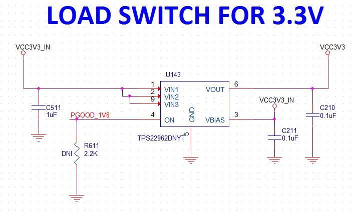

Please review my design of TPS22962 and let me know if you have any comments.
Vin = 3.3V
Vbias=3.3V
ON=3.3V from PGOOD of a regulator
The 9th pin is Thermal pad connected to VIn
Please let me know your review comments

Hi Manu,
I don't see any issues with the design. The CIN/COUT capacitors follow our recommendations, all the pins are connected correctly, and all the voltage levels are within the device specifications.
