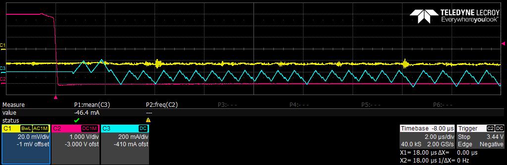

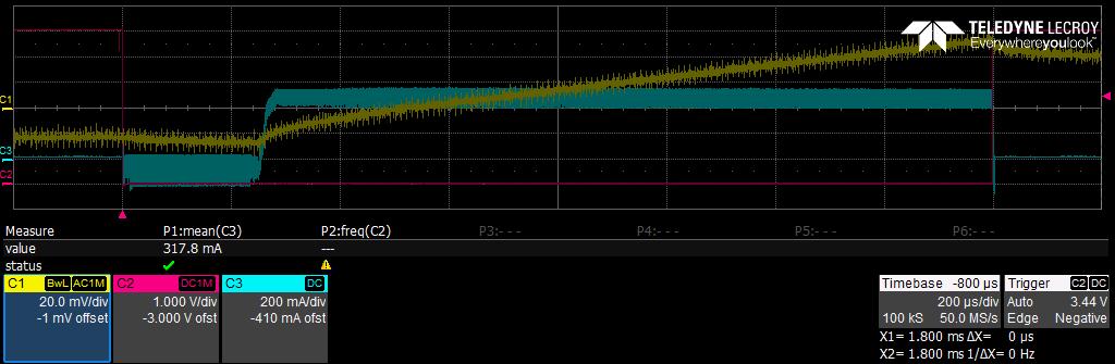

  • Dear Chris,
    Attached you can see the waveforms (the latter is a zoom of the former) for Vin=6V, Vout=3.3V and Iout=10mA, where:
    Channel 1: output voltage in ac coupling
    Channel 2: FB signal. In my circuit the output voltage is on purpose monitored by a comparator (with hysteresis) that activates the DC/DC converter through the FB input.
    Channel 3: Inductor current measured by a current probe.
    Note that at the beginning the inductor current is negative, i.e. the current goes from the output to the input. I’ve found your article “testing tips for applying external power to…” which says that in the TPS62750 this current path should not be possible.
    Do you have any idea of why the current evolves in such a way?
    Ferran
  • Can you show how you are driving the FB pin? If this is the red trace, it seems to go from several Volts to 0V. It should be at 600 mV for the IC to be regulating.
    When FB first goes low, the IC is sinking current for a brief time to reach the new Vout setpoint. This is why the inductor current is negative.

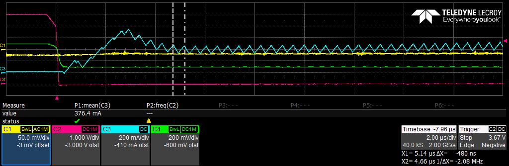

  • Hi Chris,
    Many thanks for your advice! Today, I’ve proved it and it works properly without the negative current at the beginning!! Look the new response (channel 4 in green line is the actual voltage applied to the FB input, with a high level of around 650 mV and a low level of 300 mV):
    However, the DC/DC converter works correctly only when the H/L pin is in high level.
    When the H/L pin is in low level, again we have a negative current. To be precise:
    When FB is low (i.e. around 300 mV): the inductor current is positive, and there is a charge transfer from the input to the output, as expected.
    But when FB is high (i.e. around 650 mV): the inductor current is negative, and there is a charge transfer from the output to the input. Theoretically, no switching was expected in those conditions. Do you have any smart advice to solve this problem?
    By the way, if finally we get good results from our experiments and taking into account your help for the development of our setup, maybe you would like to be one of the authors of any potential journal/conference publication. Please, let me know.
    Ferran
  • Glad that is working, with H/L = high!
    With H/L = low, can you post that waveform? The device sounds like it is operating in forced PWM mode, with H/L = low. This will not work for your use case.
