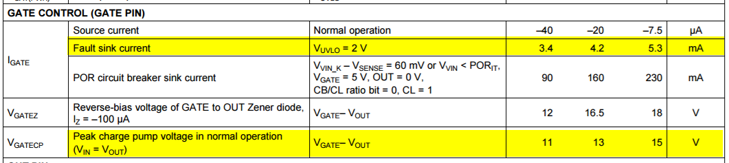

1)      When the circuit is running and I need to disable the hot swap circuit by pulling low on the enable pin of LM5066I, I would like to know the delay time between enable pin of LM5066I and the output of hot swap circuit. How long does it take?

    1) Since the EN pin is being pulled low, the 4.2mA gate sourcing current is activated. To calculate the time it takes to shut off, we can use I=C*dV/dt, where I is the constant current source in our IC (4.2mA), C is the capacitance of the cap (usually one FET is about 10nF), and dV is the voltage above Vout (13V typical for our device). Using those value, dt = (C*dV) / I = 10nF * 13V / 4.2mA = 31us
    2) Yes, please use the shorter pin connector so that the device is powered off first. If not, arcing will occur.
