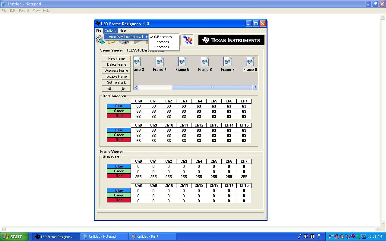

    1.Our requirement of auto play interval is 0.2sec but in EVM 0.5sec is minimum, so i selected 0.5Sec.

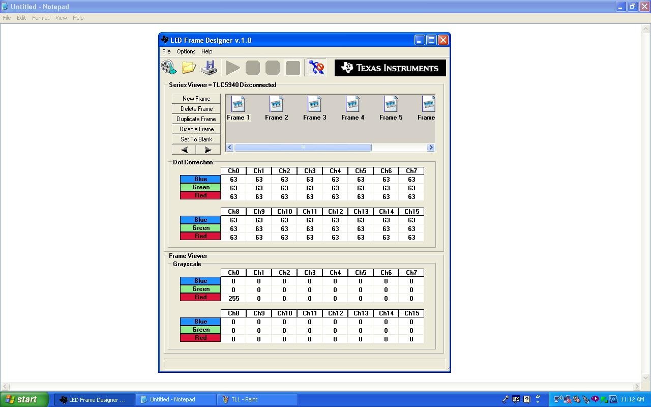

    2.I made 8 Frames with RED LED ON in sequence as follows
                 CH0  CH1  CH2  CH3  CH4  CH5  CH6  CH7
    FRAME-1 RED  255   0    0    0    0    0    0    0
    FRAME-2 RED  255  255   0    0    0    0    0    0
    FRAME-3 RED  255  255  255   0    0    0    0    0
    FRAME-4 RED  255  255  255  255   0    0    0    0
    FRAME-5 RED  255  255  255  255  255   0    0    0
    FRAME-6 RED  255  255  255  255  255  255   0    0
    FRAME-7 RED  255  255  255  255  255  255  255   0
    FRAME-8 RED  255  255  255  255  255  255  255  255
    NOTE:PLEASE REFER ATTACHMENTS FOR FIRST FRAME
    GREEN & BLUE are set to 0 (Zero) value.
    Dot correction value: 63 count for all channel & frames.

  • Please refer the attachment for 8th frame
