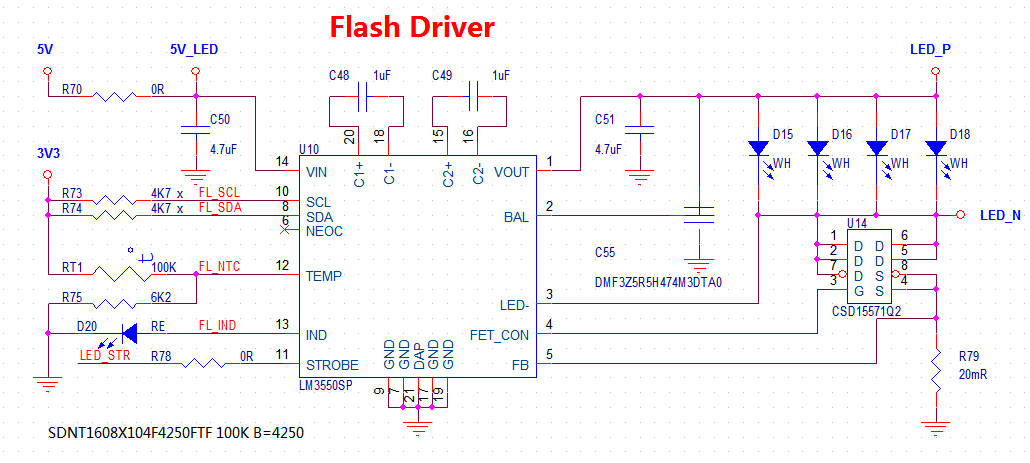

LM3550: I2C works fine, registers can be read and write, but the super cap can't get charge, and no matter how to config the registers, the flash and torch won't work even if charge the super cap manually
Part Number: LM3550
This is the schematic
    Can you provide the I2C sequence of commands you have used to this point?
    Which charge voltage target are you looking to use?

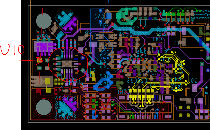

    The schematic looks ok from a first pass look.  Can you attach a snippet of the layout?  I am curious to see how close C50, C48, C49 and C51 are to the part.

  • I looked at your schematic and it looks to be correct.  I opened up the layout files and tried to look at the layout.  I am not as familiar with the allegro viewer.  Are the flying capacitors connected to the C1 and C2 cap nodes on the other side of the PCB from where the IC is?  It is very odd that you don't see any action on the VOUT node.  When you enable the device in charging mode, can you monitor the input current?   Were you able to look at the input voltage node when you enable the device?  If the I2C is working, the part should show signs of trying to switch.  Scope photos in general would be very helpful.

    • the components' number is corresponding to the label in the schematic,  the lm3550 is U10, and in the layout , it's on the bottom side of the left down of the whole layout (two separate boards)
