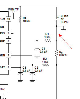

bq27000 ground layout
        If the lengh between the sense resistor and the battery ground is long. Can it affect the current detection accuracy? Like other gas gauge IC 2060. It's better to put the sense resistors closely to battery ground.
