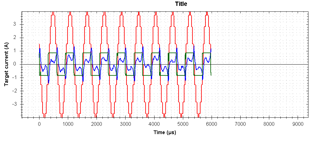

The issue is I have wired current output at speeds higher than 420 RPM above. Please have a look at the following picture.
 the Red line is our micrsoteping output which feeds to the PID refrence, the blue line is current output out of shunt resistor. green line is output of PWM. PWM 1 means 100% in forward direction and -1 means 100% in backward direction. as you can see my PWM reach to maximum but still the desire current is not being achieved. I know this is due to back EMF stuff, still the shape is not very logical to me and I m not able to explain it.

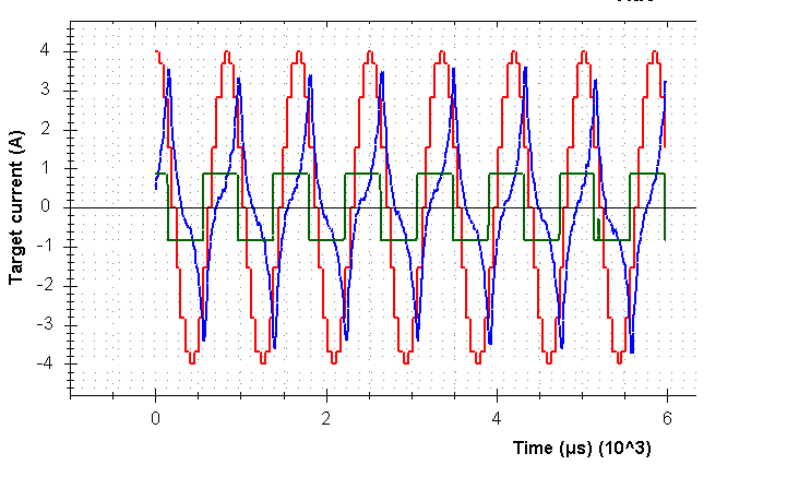

however at lower 300RPM I get something way more meaningful please have a look at the following picture.
although the feadback current due to inductance is messed up but still is acceptable.

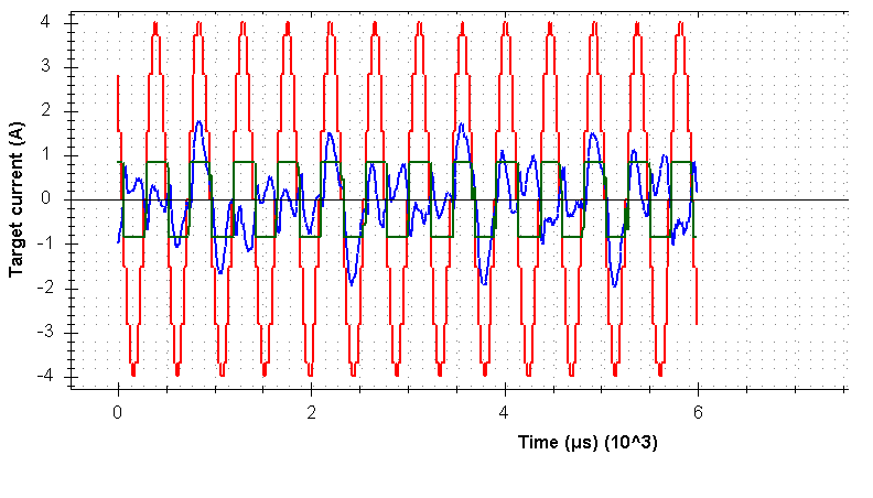

if i go for higher RPM  the graph  get worst. the following graph catured at 600rpm
 If I go a bit higher RPM than this the motor stall.
So I wonder if anyone could help to explain the graphs , and even it would be better if someone could help to solve this problem.
For your info
  • the Vbus voltage is 24 volt --> I cant change power suplly source due to cusstomer specefication. however I have tested the 48 volt which obviously give much more decent output due to better ability to overcom BackEMF voltage
  • the motor inductance is 2.1mh
  • the resistance is 1.1 ohm
  • the motor rated current is 4.0 A/phase

    Actually we run PID at the same speed rate as PWM frequency which is 25KHZ. And we have tried higher speed PID and PWMs . Up to 100khz which is quite high. Still the result is same and no we achieve no improvement.
    The PID get saturated in high speeds and it forces the PWM to 100% duty cycle. the response is very fast which is correct but the current output cannot even get close to to request reference, not reaching to refrense is not an issue but the shape of current get disorted , and this shape distortion is an issue . In my humble opinion, this is not PID response time issue. I have to mention we have competitor which we test bench our product with at the same speed they fully reach to 100% pwm exactly like us. but when we measure their current output with our very expensive accurate current probe their output is really meaningful oppose of us ,our current output at full speed and under 100% PWM duty cycle is really messed up.
    Our original PWM was centered aligned. but yesterday we tried a PWM signal which is exactly look like slow decay PWMs inspired by TI reference designs. As a result the current output become more stable, but after some time hardware get unstable and started to burn . we tested the new pwm few times, one time INA240 burns another time LM5106 burns, another Time one of the mosfet burns. still testing the Slow decay PWM signal once I get better result I will update you again regarding it.
    But still my competitor runs a centered aligned 25KHZ pwm and they set PWM duty to 100% and they have very meaningfull current output and we don't .I really dont know where the problem comes from.
