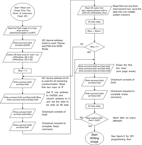

   We are using a BQ27500 monitor chip and we have with us a golden image file supplied by TI for our batteries.
   We have followed slu449d.pdf for programming the golden image to the chip.
   We try to program the BQ27500 chip  and are unable to access any register access with address 0x55
   after we program the chip in ROM Mode.
 The following 5 steps are successful. I2c writes DONT report any errors.
1) Enter ROM Mode (I2C Address is 0x55)
2) Copy First 2 rows of instruction flash contents and Erase 2 rows of Instruction Flash. (I2C Address is 0x0B)
3) Writing Image - T(Also the DFI Checksum matches with Read Back Checksum on the chip) (I2C Address is 0x0B)
4) Reprogram the First 2 rows of the instruction flash (I2C Address is 0x0B)
5) Exit ROM Mode and Write Bytes 0x64 = 0x0F and 0x65 = 0x00 are successful.  (I2C Address is 0x0B)
The i2c writes dont report any errors.
The issues is the chip never exits out of ROM Mode. Any reads/writes to 0x55 addresss returns -5.
What could be the issue?
Also, If i omit the Step 1 (Enter ROM Mode) - I can program the image again and again without any issue.
but unable to come out of the rom mode.
I suspect that the BQ chip is unable to exit the ROM Mode for some reason.
What are the steps to put the chip back into a default state?
Please advice.
Thanks and Regards,
Sriram V.

     I am following the flowchart http://focus.tij.co.jp/jp/lit/an/slua449d/slua449d.pdf exactly. (Pages 8 to 11)
     Before i exit the ROM mode i write the following as given in the flowchart:
     Command 0x00, Data 0x0F
     Command 0x64, Data 0x0F
     Command 0x65, Data 0x00
     Send RESET on 0x55 === FAILS
    Delay(1s)
     Send IT_ENABLE on 0x55 === FAILS
    Also, Can you please let me know which command i am supposed to run to execute the firmware?
    Are there any specific command to run in ROM Mode.
    I do a RESET and IT_ENABLE  ( 0x0041 and 0x0021) after exiting from the above commands.

  • Do you mean SLUA449d instead of SLUA559d?
    Is your problem at the last step of Figure 10?  After this step it should be responding to I2C traffic at the usual firmware I2C address (0xAA).
    There is no read of register 0x66 for this final step.  Can you please explain your issue another way?
    If you somehow corrupted the dataflash or didn't successfully program everything correctly then the IC will remain in ROM mode and will not execute the FW.  That could be what is happening to you if it's not going to Firmware mode.  That's why the flow charts have you go back and start again if 0x66 doesn't return 00.
    By the way, some customers have run into problems on Figure 8 where they erase the wrong two rows, so we are about to update SLUA449D (next version should be E) Figure 8 with the flowchart below.  The sixth shape from the end is adding writes of 0x00 to addresses 0x01 and 0x02 in case they somehow got changed elsewhere.

  • If you didn't successfully finish programming the golden file into dataflash then it should stay in ROM mode even if you POR.  It should still be in ROM mode for you and you can retry programming it using the updated flow assuming it still responds to address 0x16.
    Another thing to confirm is that you are programming a DFI that is compatible with the FW version loaded on the IC.  For example, if you made a golden file for bq27500-V130, do NOT program it onto an IC with another FW version, like bq27500-V120 or bq27510-G2, for example.  In most cases it will brick the IC, but it's theoretically possible that it might make it stay in ROM mode or even execute FW and look mostly normal to the casual observer.
    So...
    - Does every step of your code leading up to the end of Figure 10 get successful results (0x00 in 0x62)?
    - Are you sure your DFI file and IC FW versions match?

    I think you might have pointed me right to my issue.  I used the BQ27500EVM kit to create the golden image and when I look at the bottom of the BQ Gas Gauge Eval Software it says "Device: 500, Ver: 1.08"  I used this golden image and programmed it into my BQ27500 v130 chip on my product.  That being said, am I now SOL?  Or is there a way to see if I can recover from this situation if I don't think I have ever successfully exited ROM mode?
    In hope that I might not be in a bricked situation,  I discovered that I am getting a response of 0x04 from register 0x66 after I write the first 96 bytes of data in Figure 10.  (Bottom block of the first column of instructions)  I have been using this gas gauge for development so it is very possible that the yIFRowData_iRow[0->95] was corrupted earlier.  Does this data have an internal validity check in the IC to make sure the 192 bytes that are being sent from the host application makes sense?
    Sooo....
    1.) Am I SOL or is there a chance that I can recover from this situation?
    2.) What does 0x04 mean when I read register 0x66 in figure 10?
    Thanks!
    -Colin
  • If it is responding in ROM mode (ACKing the ROM I2C address of 0x16) then you can still recover.  Since you didn't complete the process and stopped on the error the gauge will never try to run FW.
    You have two paths now:
    a) Use EVSW to upgrade your EVM to bq27500-V130 by downloading the SENC from the product folder and following the instructions on page 5 of http://www.ti.com/litv/pdf/slua453a.  You can skip step 5 since you are already in ROM mode.  Once this is done you can retry your DFFS.
    b) Alternatively you can try using the bqfs file which will program the dataflash AND instruction flash, thereby upgrading it to bq27500-V130 and programming your custom dataflash at the same time.

  • Notes to consider:
    For IF Data, the maximum value on every third data on both IF Rows is 3F...
    Writing the exact value being read from Page 8 of SLUA449 or SLUA504a will resolve the issue on 0x04 on Register 0x66 after IF Data Write
    (Page 11).
    BUT, I encountered another issue -- after exiting from ROM Mode without any error, the device cannot be accessible anymore...
    Need some experts here on how to resolve this issue,,,,
  • Issue resolved....
    In writing the IF Data and DFI Data, it should NOT be in little endian format.
