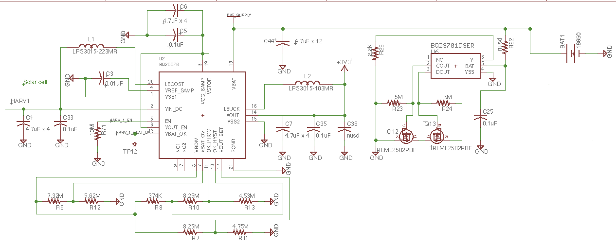

I create a PCB with the attached schematic.  I tried to follow the application in the datasheet.  I added the lithium-ion battery protection circuit but this should not affect the charging of the battery.  I am using a couple 3V solar cells from powerfilm solar (part number LL3-37) on the Vin-DC pin.   I hve ground the EN pin on the PCB.  There is no MCU control to this circuit.  Finally, the Lithium battery is currently at 2.049V and I am attempting to charge it without a load on Vout.
I have tried both a single solar cell and 2 solar cells in parellel.  The open circuit voltage is 3.0V.  However, when I connect the solar cells to the BG25570 on the Vin-DC the in circuit voltage drops to 0.432V. .... not 80% of 3 V as the datasheet says it should.
When I add light to the solar cell the voltage on the battery is slowing increasing about 0.001mV every 15 seconds so it is doing something but it never gets up above 2.1V.   Clearly the 3.7V lithium battery is not charging.
I am sure it has something to do with the configuration of the IC.  The in circuit voltage on the Vin-DC does not increase when I use 2 cells or 1 cell.  The voltage on the solar panels is always 0.4 something volts not 80% of the 3V open circuit voltage.
Any idea what I am missing.   Attached is the schematic.
  • Hi Chris,
    Is VSTOR sitting at your battery voltage? This will determine if the PFET is on.
    What is your VOUT voltage at?
    Do you know what the equivalent capacitance of your battery is? There should be at least 100uF of equivalent capacitance from VBAT to VSS. You could try adding come capcaitance on VBAT.
    Also, can you try only charging the battery or cap without the BQ29701? This way we can rule out that it is not causing any issues. It looks like all you would need to do is depop R22.
    -Joe
  • Hello Joe,
    Thanks for your help. I made a couple of changes as you suggested.
    1. VSTOR is the same voltage as the battery.
    2. I actually do have a 100uF added to the battery....sorry not in the schematic. ( it was a troubleshooting mode and forgot to add it.)
    3. I also increaased C6 from 4.7uF to 26.7uF ( added a 22uf cap)
    4. I removed R 22 so disconnecting the BQ29701.
    This last change created some improvement.
    1. The battery can now be charged above 2.6V.
    2. The in circuit voltage on the solar panel is now 1.43V, which is very close to 50% of the solar panel open circuit voltage of 2.99V.
    So maybe there are two issues.
    1. The BQ29701 is loading the battery.
    2. It appears the BQ25570 is configured for 50% of the source open circuit voltage. Of course it is not VCC_SAMP is connected to VSTOR so I should see 80%.
    Any thoughts on these two items? How can I fix these?
    Chris
  • Chris,
    What kind of capacitor are you using on VREF_SAMP pin? Leakage on the VREF_SAMP pin can cause problems with regulating VIN. It is recommended to use a low leakage X7R or COG low leakage capacitor.
    You may also want to try increasing your input capcaitance. It could be that your input is having troubel staying at the 80% set point. Have you connected this up to a scope yet? You could monitor the input and see if it ever spikes to the 80% set point and then sag down to 50%.
    Also, you mentioned the EN pin is grounded. Does that mean the blue line in the schematic is ground? If so, it looks like the VBAT_OK pin is grounded as well. This pin should be left floating if not being used. Grounding it may be providing a leakage path.
    -Joe

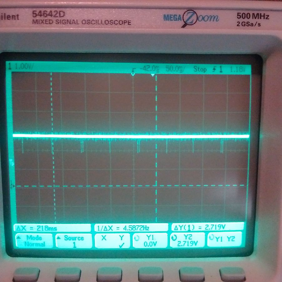

  • That is a good point.  I am using a bunch of different types of capacitors,   X5R, X7R and COG.  I changed all of the capacitors so they are all X7R.  Some of the values had to be created using many caps.  I have updated the schematic to reflect what I did.  Also EN is grounded and VBAT_OK is floating.
    I have ordered some more capacitors, which should arrive tomorrow. So I can swap out some of the caps where I had to use many.
    I also took a screen shot of my oscilliscope measurement of the input voltage.  See below.
    The screen shot shows the voltage is not steady at 2.656V but is pulsing.  I need to increase the capacitance I think.  I ordered some 47uF and 22uF caps of X7R.  I will try them tomorrow.

    The input voltage on my scope shows the following.
    When I increase the capacitance of C4 to 96uF  the voltage is steady at 0.3V with no ripple.   The added capacitance kills the waveform so I removed it.   C4 = 47uF.
    The voltage on the battery is charging.  It is increasing 0.001v every 7-8 seconds in the range of 1.579v to 1.580v range.
    According to the datasheet, I believe the input voltage should be somewhere around 2.4v measured by a volt meter.  I do not know what it should look like with a scope.  Is it suppose to have this waveform on it?  A changing cap waveform would be reasonable.    What should the waveform on the input look like?
    I am going to let this run overnight an see if the battery charges.
    Chris
  • This is not what is expected on the input. The input voltage should stay steady at the MPPT set point and then pulse to the open circuit voltage every 16s for a short sampling period. Refer to figure 27 on page 25 of the datasheet.

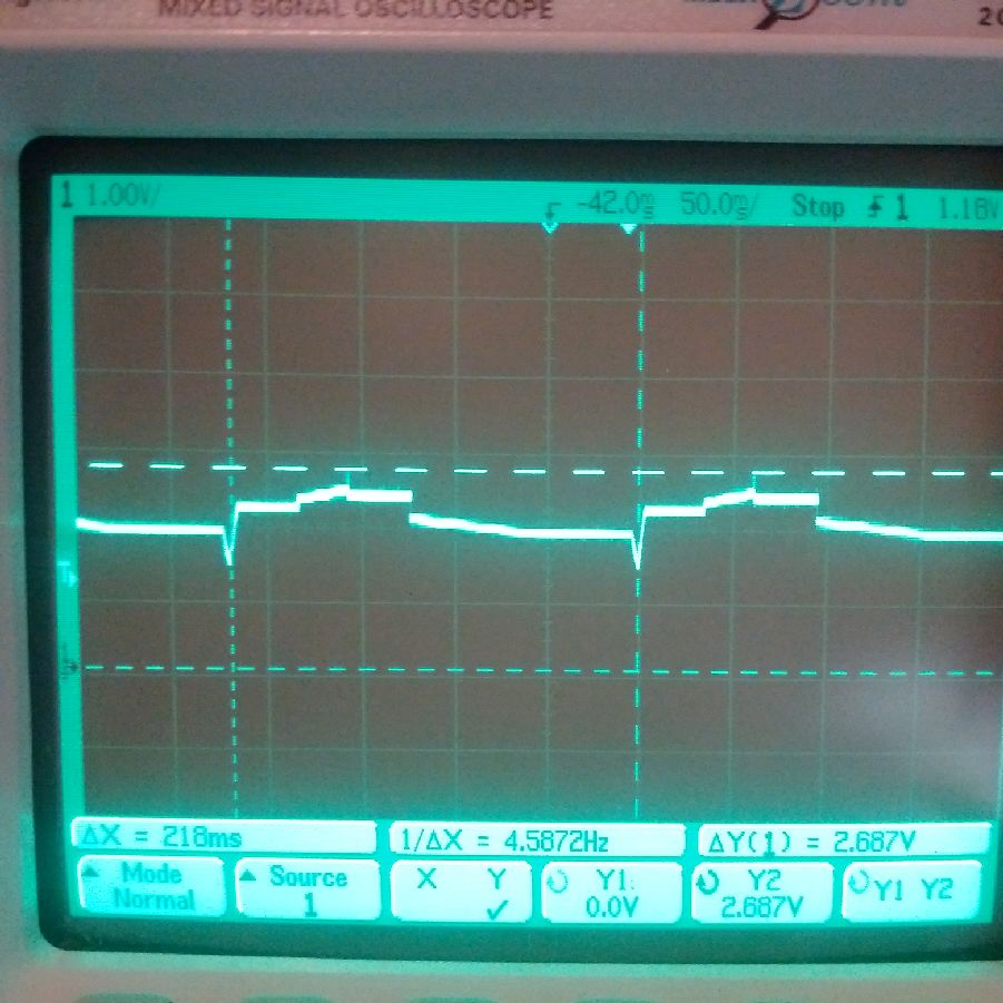

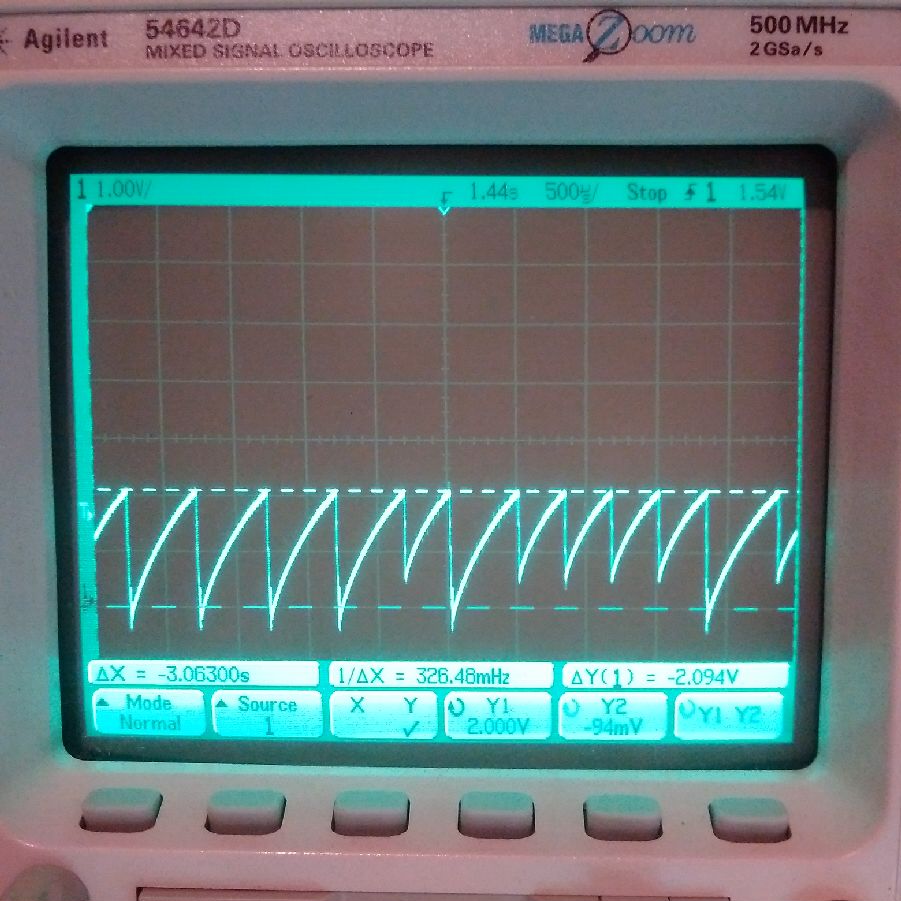

  • Hello Joe,
    I did the following.  Changed C4 and C6 to 4.7uF and removed the battery.  The battery line now as 2 47uF X7R caps on it.   I did some measurements the first three photos are with the solar cell from PowerFilm  ( LL3-37)  -->   http://www.powerfilmsolar.com/products/?ll337&show=product&productID=284197&productCategoryIDs=6573
    scope measurement of Vin with Solar cell
    Scope measurement of VSTOR  with Solar cell
    Scope Measurement of VBAT with Solar cell

  • Hi Chris,
    What your waveforms are telling me is that the IC is stuck in cold start mode when the solar panel is on the input. This can be seen from your VSTOR waveform. It looks to me that every 220ms or so the VSTOR voltage drops below the VSTROR(CHGEN) threshold of ~1.7V. This can cause cold start to restart.
    Also, since VSTOR is reaching 2.7V, which is above VBAT_UV of 1.95V, the internal PFET connecting VBAT and VSTOR is turning on. This then turns back off when VSTOR dips. This is why you see a voltage on VBAT That is not equal to VSTOR and definitely not your set VBAT_OV voltage of 4.2V, which can be seen in yoiur waveform of VBAT with the solar panel.
    Are you loading VSTOR at all? I know your schematic doesn't show it, I just want to double check. Loading on VSTOR can cause dips.
    I suggest increasing the capacitance on VSTOR so it doesn't drop below 1.7V. Check again, VSTOR and VBAT waveforms.
    -Joe

    Here are some screen shots.
    VIN
    VSTOR
    VBAT
