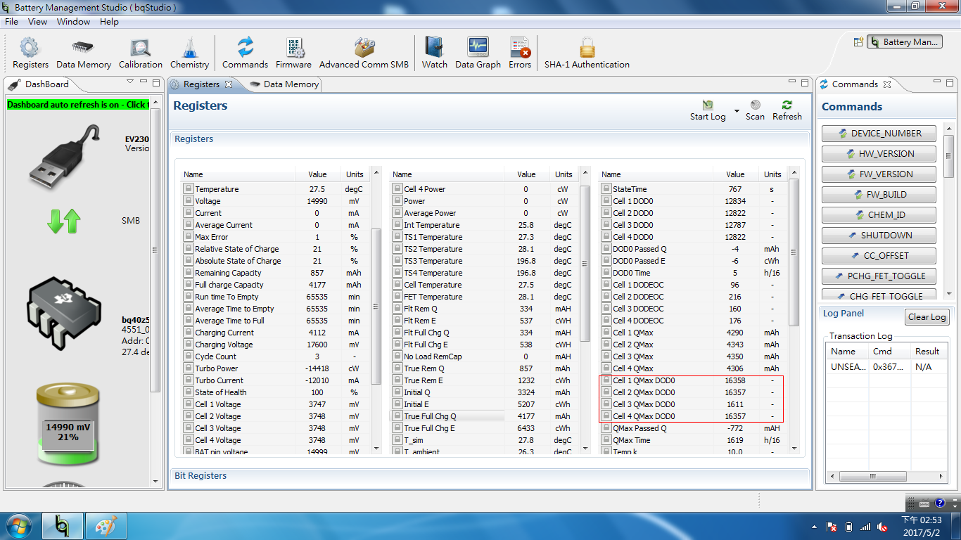

This is Jimmy, I met a issue is bq40z50 FCC low about 371 but normal should be 4177, check the SBS, observed the Cell QMax DOD0 as below:
Cell 1 QMax DOD0 is 16358
Cell 2 QMax DOD0 is 16357
Cell 3 QMax DOD0 is 1611
Cell 4 QMax DOD0 is 16357
May questions is what condition caused Cell 3 QMax DOD0 become 1611?
Can I have your help? Thanks.
