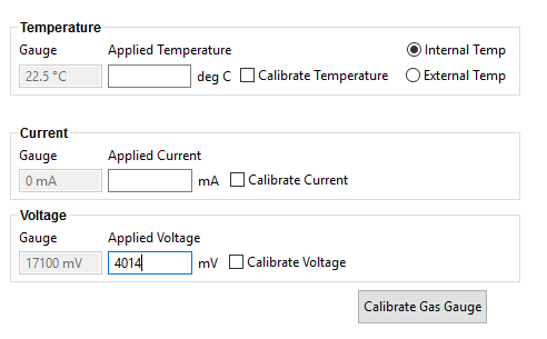

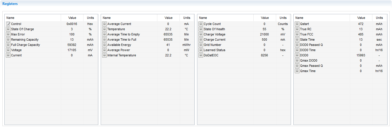

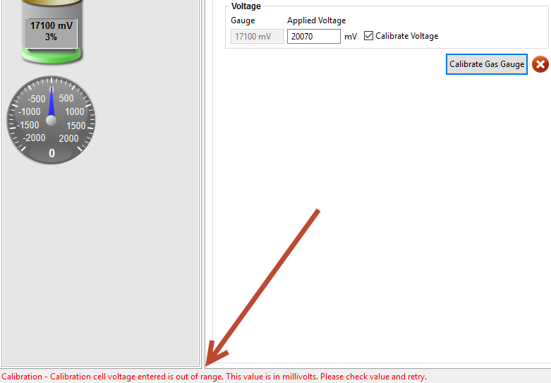

Hi. I have an LI ION 5 cells pack connecteted to the EVM. But i cannot calibrate the Applied Voltage.
The Pack has 20070mV / 5 = 4014mV
It gives allways the same error. -> Callibration - Failed to enter calibration mode with command 0x2D
i would like to Attached an export file, bnut also not work
