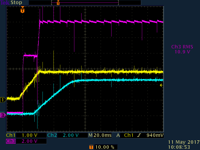

When  no load condition, output 12V,  waveform are correct
CH1: UVLO pin, CH2: SS Pin, Ch3: Vcc pin

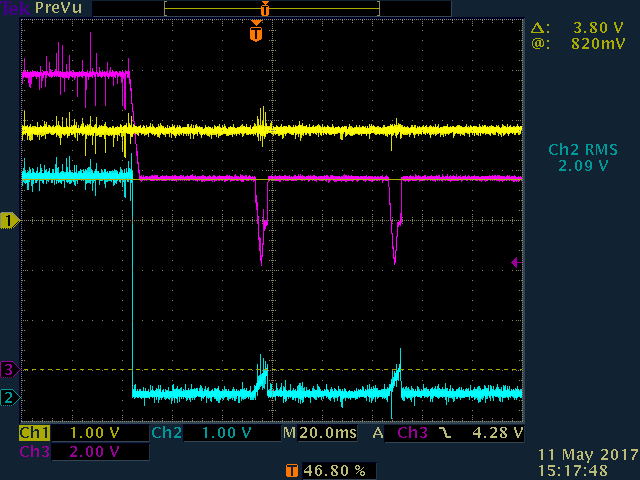

When the output current is 2A, VCC drop down to 4V
I have tried to connect VCCDIS to GND, but the situation did not improve,
Is there a better solution ? Please give me advice

  • Hi Yu Hsiang Shen,
    What is the inductor value you are using in your design?
    4.7uH corresponds to 50% of inductor current ripple - that may cause the design to hit the current limit.
    15uH usage will result in 20% of current ripple.
    It's not clear what value you are using when I'm looking at your schematics and BOM.
    Can you have a look at the voltage at CS pin to determine if the design is going into current limit or not?
    Piotr
