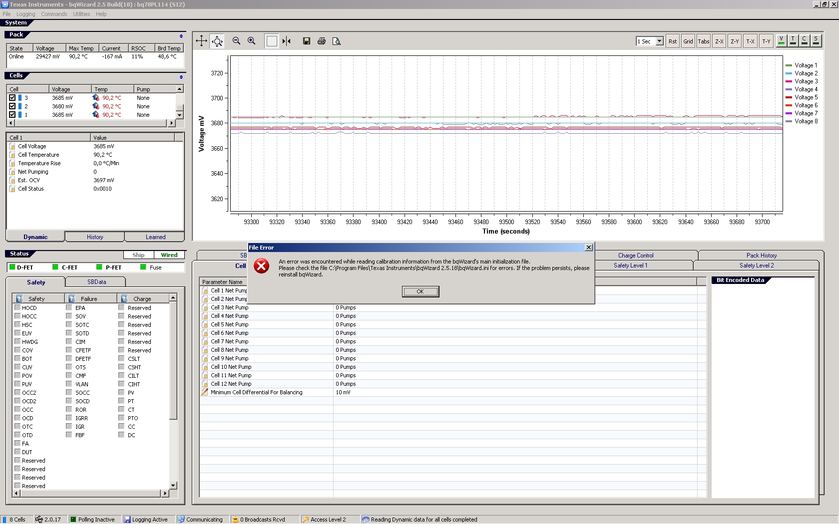

European customers who use the bqWizard may encounter an error message after calibration.  See attached.
To fix this, do the following:
  1. Locate the bqWizard.ini file in the root directory of the bqWizard installation.
  2. Save a backup copy of this file under another name like bqWizard_backup.ini.
  3. Open the original file using a text editor.
  4. Locate CurrentGainError=0.001.
  5. Change this to read CurrentGainError=0,001.
