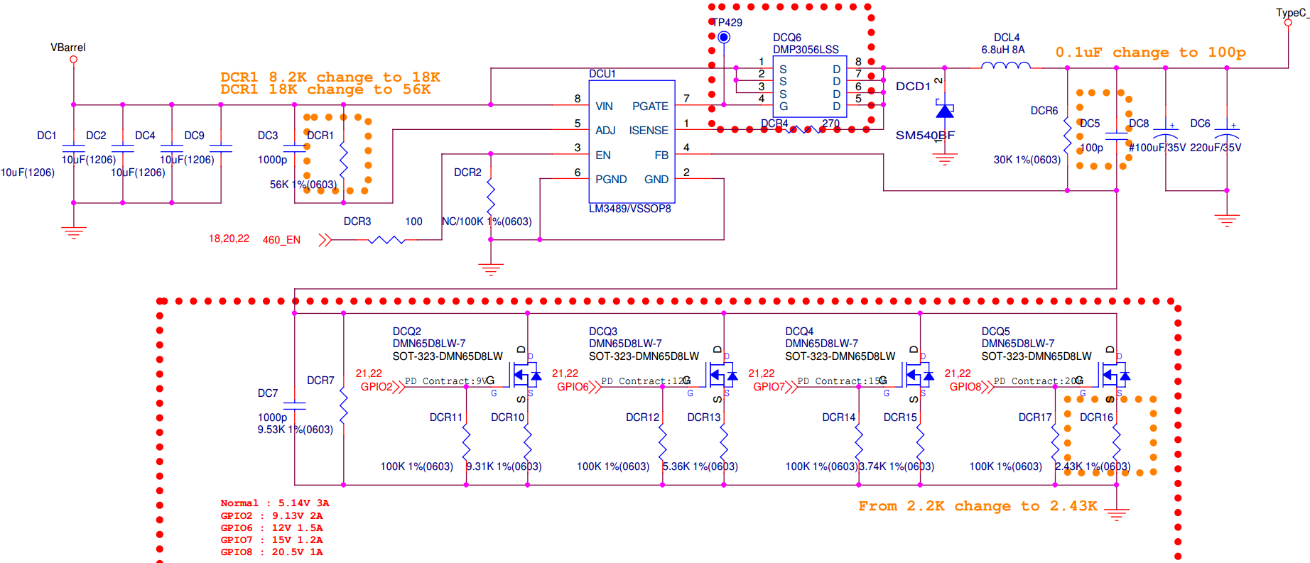

We use LM3489 on Type C PD application. (5V_3A /  9V_2A / 12V_1.5A / 15V_1.2A / 20V_1A)
I use 8.2.2.1 Inductor Selection equation, but can't get reasonable value. Please help to confirm if we can use 4.7uH. Thanks.

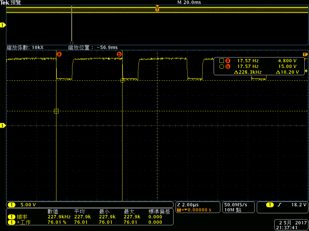

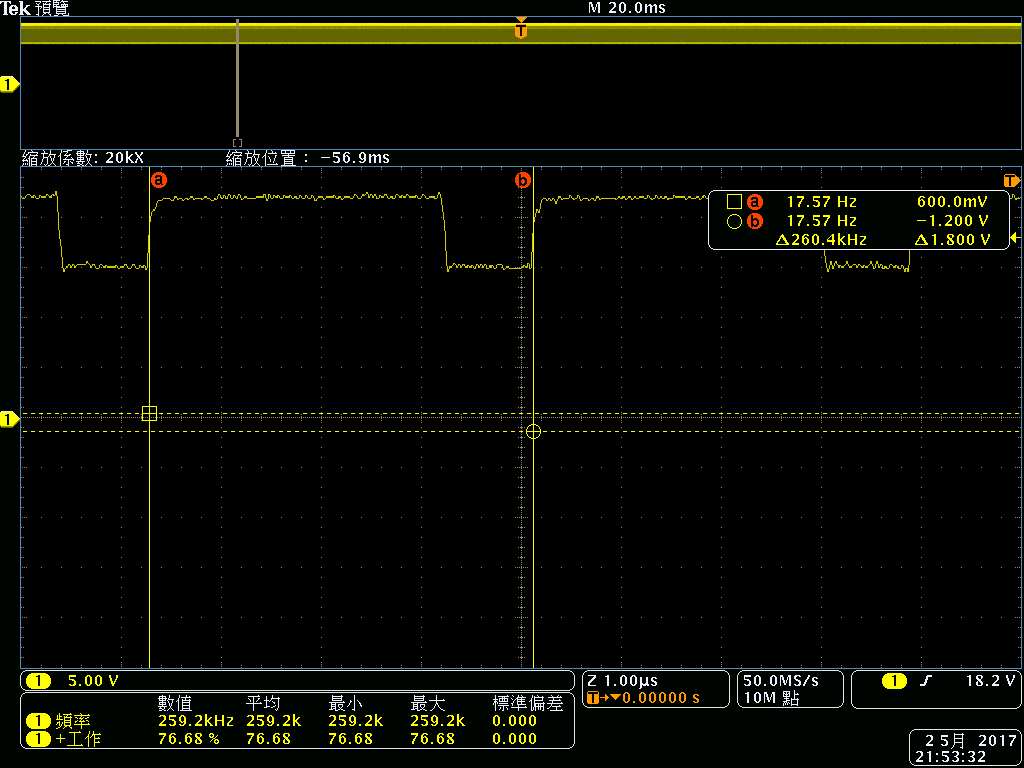

Vin=22V, VDS=as attached PFET datasheet(DMP3056LSS), VOUT= 5V_3A /  9V_2A / 12V_1.5A / 15V_1.2A / 20V_1A,  D(Duty cycle) & f(Operating frequency)=as attached waveform.
4.7uH : duty 76.68% frequency 259KHz
6.8uH : duty 76.01% frequency 227.9KHz

  • Daniel,
    I would recommend using 10uH for the Vo=5V and 22uH for higher Vo such as 9V,12V,15V etc.
    Using 4.7uH pushes the frequency too high.
    Step 1: Set  delta I to Iout ratio =0.3 to 0.4  and then calculate delta I
    Step 2:  Substitute L with 10uH and see what freq you get. In the equation D changes as per your output voltages.
    Mathew

    We want to reduce the inductor because the temperature on 6.8uH is too high, and 4.7uH would reduce the inductor temperature.
    (5V_3A loading)  6.8uH: 92℃,  4.7uH: 75℃
    Could you give us some advice to reduce the operating temperature? schematic as attached.
