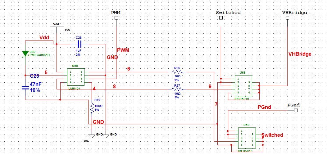

with the attached circuit I measure the temperature at the top of the LM5104 at around 70 celsius during normal operation. The device fails intermittently which may or may not be related to the temp. Package is the SOIC-8. LM5104 is being driven at 1kHz, 5%-95% duty. FETs are supplied with around 14.5v. Vdd is a 15v stabilised supply.

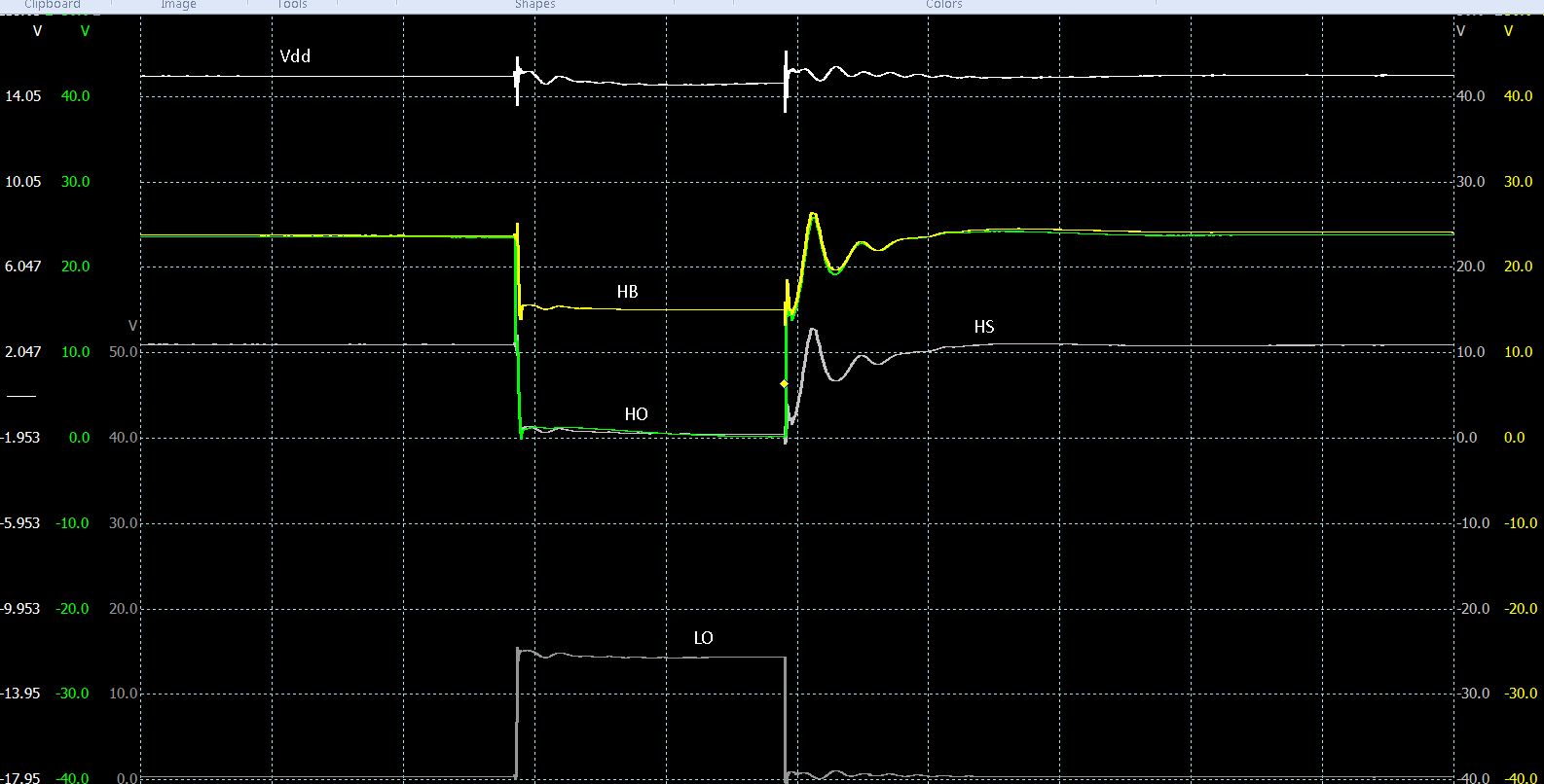

    Thanks for including schematic and waveforms. Your schematic looks good. I would recommend a second capacitor at VDD, close to the device pins, in the range of 100nF to provide high frequency current during turn-on/off. From the waveforms it seems that VHBRIDGE is at 10V. Please confirm if this is the condition when the LM5104 fails. Also, what is the time scale for the waveforms shown? I am trying to determine the severity of the ringing on the HS pin.

    1. To determine if related to the capacitive load conditions (PCB traces + MOSFET Ciss), please try running with R26/R27 removed from the circuit and check the temperature and for any incidence of the failure mechanism.
    2. To see if there is a need for more dead time, please try increasing R19 to 100kohm, running again, and checking as above.
    3. Try also adding turn-off diodes in parallel with the gate resistors as shown in the typical application section of the datasheet. This will result in faster turn-offs, which in turn should reduce power losses.

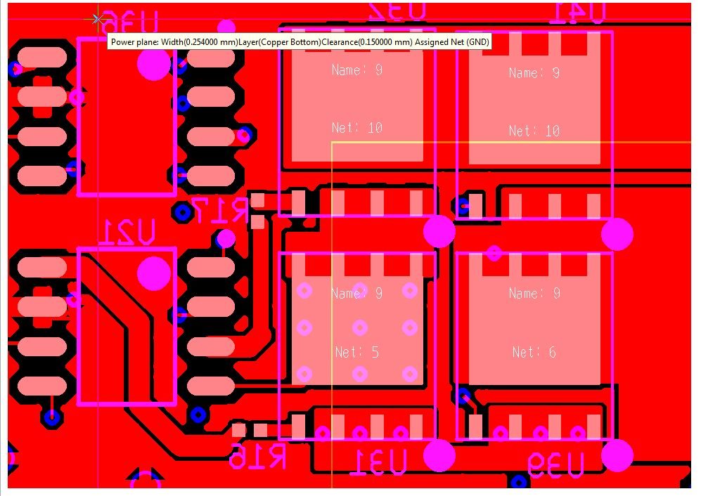

    PCB layout also can have an effect on performance. I can review the board layout for you if you share it.

    -          Replacing R26, R27 with 0 ohm links results in a significant temperature reduction.
    -          Replacing R19 with 100k has no measurable effect.

    -          The timebase in the attached oscilloscope waveforms is around 10us/division.

    I have attached a screen shot of the PCB layout. Hopefully it makes sense to you!

    Thanks for the updates. The lower series gate resistances help drive the MOSFET gates on and off quicker, which in turn result in lower losses. Hence, the lower running temperature makes sense. I would recommend that you look at the slew rates on the SWITCH node to ensure you don't see undesired ringing. You may want to add a small resistance larger than 0hm (maybe 2 or 3ohm) to slow down the gates if you see fit. However, if the 0ohm links work out for you, then you can move forward like this and see if the catastrophic failures no longer occur.
